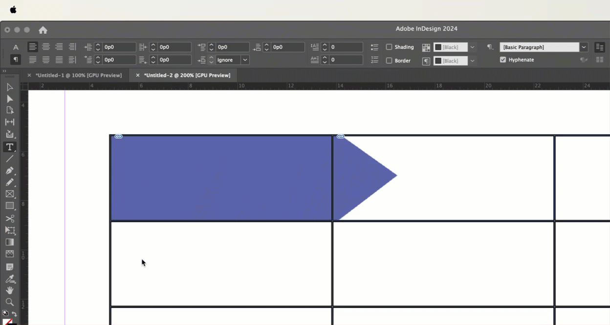

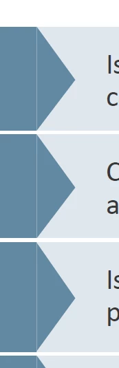

Hello. I'm creating a table and inserting a graphic into a cell next to a cell that is the same color as the graphic to create an arrow. But even though I've removed the stroke width on both sides, you can still see a thin white line between them. Is there any way to eliminate this? See attachment.

Hi @Kathy5FFA:
A couple of things to try:
  1. Make sure the vertical interior line in the proxy is selected as you set the width to zero
  2. Make sure the image is fully against the edge of the frame. You could move the graphc, resize the graphic, or you could resize the column width.
~Barb
James Gifford—NitroPress
May 3, 2024
None of the above, for me. I emptied the bag of tricks and still see that faint seam, but as noted, it doesn't export.
It seems to disappear in Presentation mode, not that that's helpful.

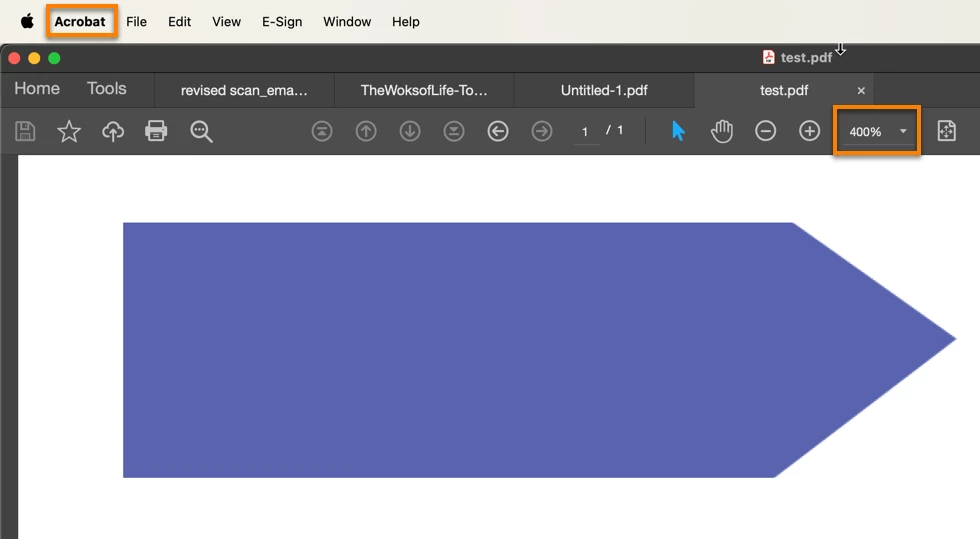

Barb Binder
May 3, 2024
Here is the same (quickly drawn, wonky) shape exported and viewed in  Adobe Acrobat at 400% magnification. I don't see it. Do you, James?
~Barb
EDIT: Sorry. You said it didn't export.
May 3, 2024
Does the line still show when you export to PDF (or JPG, if you're doing this for digital view)? Sometimes these fine artifacts in the layout disappear when exported.
ETA: I just did some quick and dirty tests and that's exactly what I am seeing. The faint line is just a screen/layout artifact and does not appear on export. Throwing a cell border of the same color on the solid cell just moves that line over a little, so I'm not sure there's any easy way to get rid of it even if it's just a visual distraction. (ETA2: And the various overprint/stroke control options do nothing useful, either. I don't think ID knows it has this line showing. 🙂 )
Kathy5FFA
Kathy5FFAAuthor
May 3, 2024
Yes. The line is still there in the pdf.
May 3, 2024
Ugh. Well, check all of Barb's suggestions to make sure the space between cells is truly 0 (and None color might help).
Also try shifting the graphic a bit left in its frame  — it may have a faint outline from some scaling or other process step.
A graphic line laid over the seam makes it disappear, but that's a complete hack.
