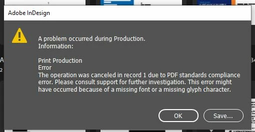

I'm getting the folloing error when trying to dynamic print in InDesign.
A problem occurred during Production.
Information:
Print Production
Error
The operation was canceled in record 1 due to PDF standards compliance error. Please consult support for further investigation. This error might have occurred because of a missing font or a missing glyph character.
The problem is that on InDesign it does not give me any font eror. So I do not know where the trouble Character is.
How can I fix this?

Can you explain some more about what you mean by "dynamic print?"
Are you doing a DataMerge to PDF?
February 24, 2023
I'm using Dynamic Print from XMPie uCreate to merge the data with the letter and create a pdf.

That's a very unusual message.
Can you upload a picture of this message, please. Also can you show us what kind of document is (is there a "record 1").  Please tell us what operating system (exactly) you're running. Please tell us (exactly) what InDesign version you're using.
February 24, 2023
It says the issue is on record 1 bt if I skip record 1 I still get the same error. If I link to a different file I still get the error.
I'm running on Windows 10 Pro Version 22H2
InDesign is 15.0 x64
Thank you for your help
Steve Werner
February 24, 2023
Here's a link which refers to the error, but there's not a simple solution:
https://groups.google.com/g/xmpie-users/c/ubYX0cROyX4
Here's the relevant section about that error:
"There are two solutions to the PDF compliance error: 1 - use a different font which has all the required glyphs, or 2 - remove the bad character from the document/data.
Anyhow, it can be easy or tricky to find the problem. If the missing character is in static text, it is easy since you should see it in InDesign. But if the character that is not available in the font is coming from the linked data, then it can be more difficult to identify. If this is the case, try to identify the record which has the bad character by printing different ranges of data. eg records 1-100, then 101-200 etc until you find the bad data."
What kind of file is this? Can you replace the font with a different font? It appears that a character or glyph may be missing in the font you're using.
