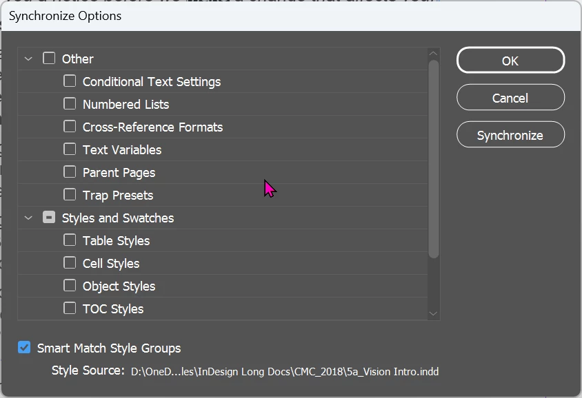

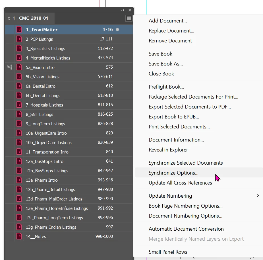

I would add your new documents to your book, select them in the book, and use the synchronize feature to make sure the styles were not changed from your originals. You set a “master” document in the book (the one with the good styles) and sync it to your new file. (This will not remove overrides, aka, manual formatting.)

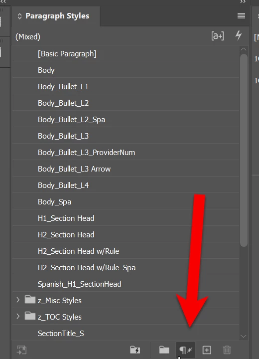

Select all the text and click the button at the bottom of the Paragraph styles panel.
This will not remove properly applied Character styles. To remove character styles, select the text and make sure the Character styles panel is set to None.

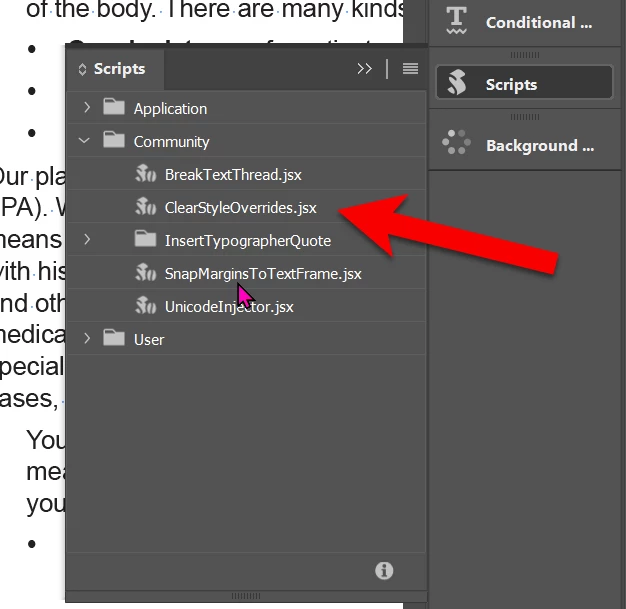

Another option is to use the ClearStyleOverrides script.

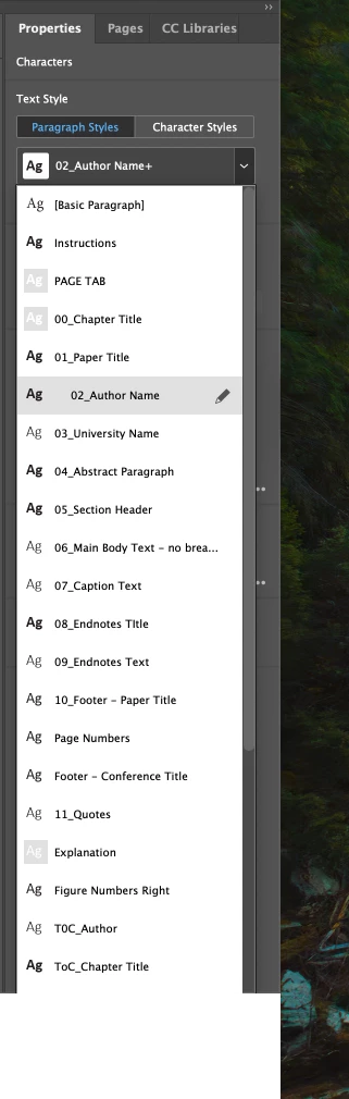

  • Lastly, yes the styles are the exact ones for the TOC. Since they are present I am applying the styles that are in the preset list.I added a screenshot below of the style list for reference.
