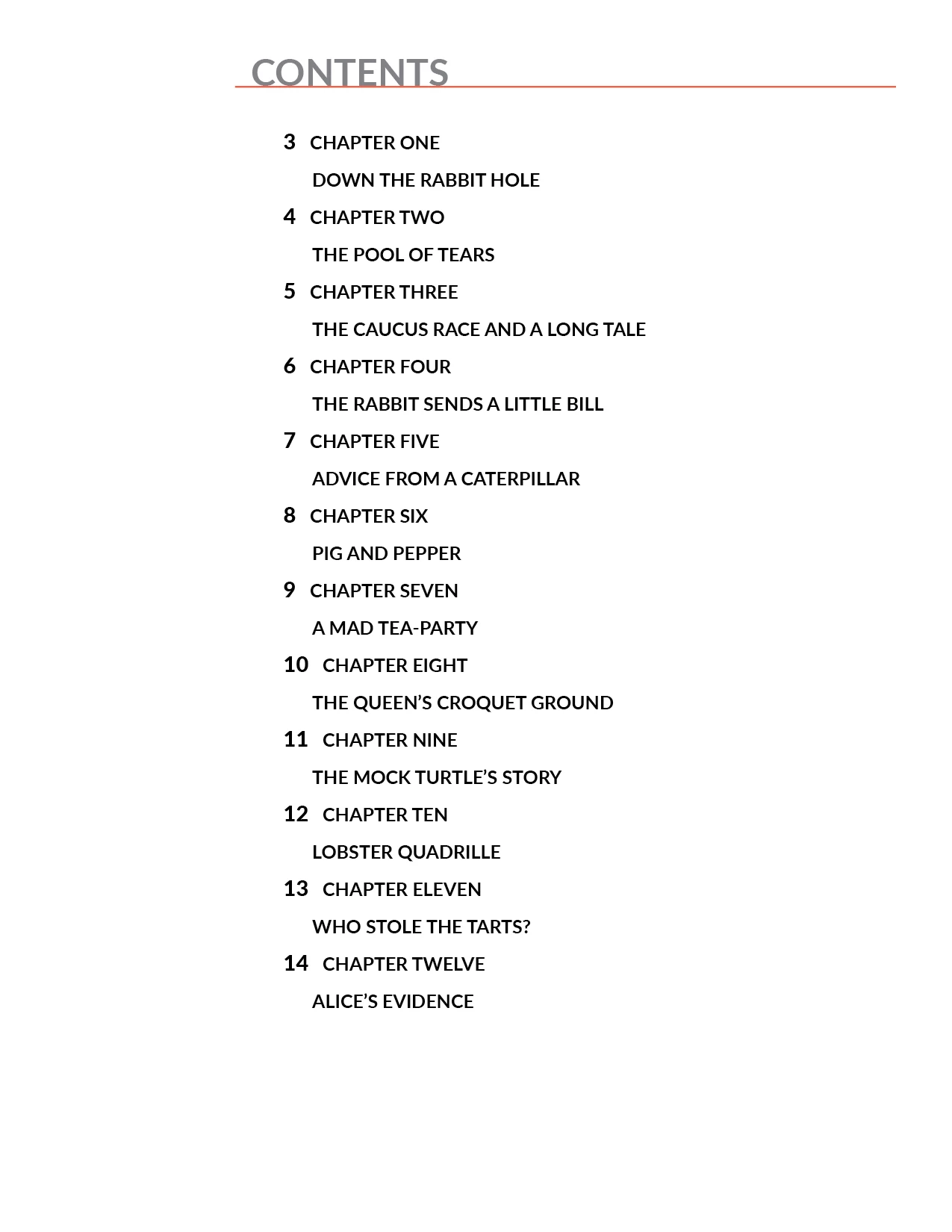

Hi, I am having problems lining up numbers in a Table of Contents. The client wants the page numbers on the left. Everything is fine until double digits. I thought I could align the numbers in the TOC paragraph style, but no luck. Appreciate any help.

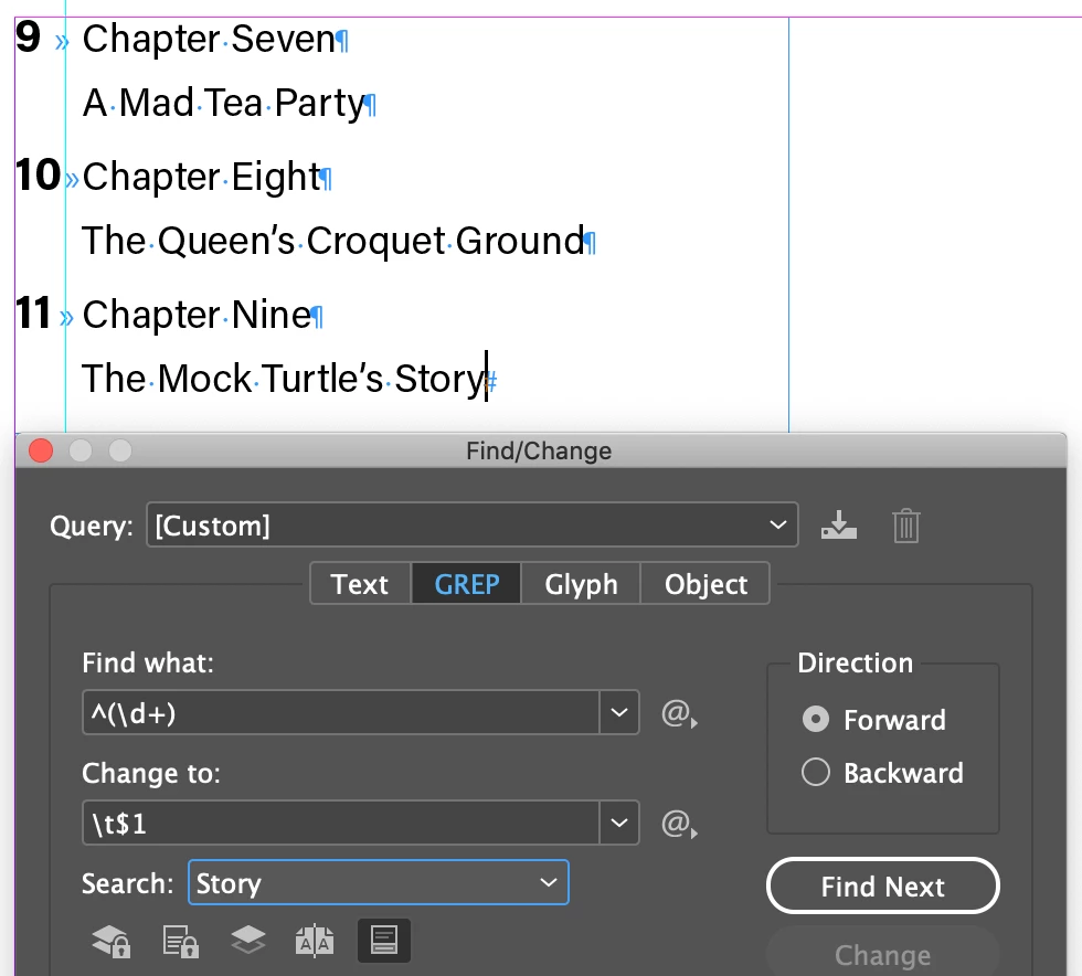

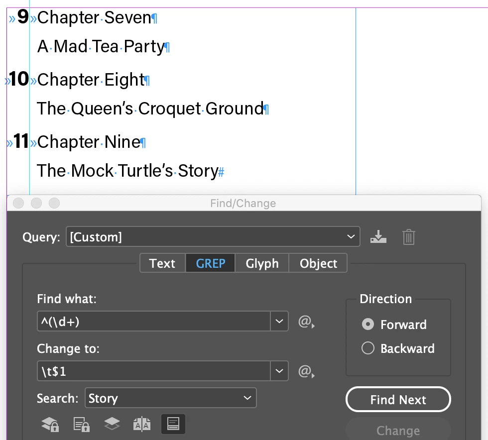

Hi UnderDog:
I know you said you are out of time, but what is missing from the TOC dialog box is the ability to leading decimal tab. You could do this quickly with a GREP Find/Change query. Not ideal, but just another few clicks.
Before:
After a change all (and updating the style to address the dec tab).
Once it is working, don't forget to save it with the Save Query button on the top row so that you can run it again after you update the TOC.
~Barb

Hi UnderDog:
Before:
~Barb

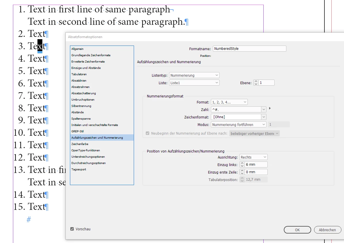

I'd prefer it this way:
No tabulator ^t defined, instead one blank after the dot perhaps,
Alignment: Right,
Left Indent: 6 mm*,
First Line Indent: 0
From my German InDesign CC 2019:
* Change that value to your needs!
Uwe

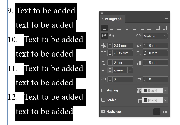

manal shanableh
February 19, 2019
the default left indent usually 6.35 mm and first line indent -6.35 mm
you can change it form paragraph, or paragraph menu>  bullets and numbering
but the best is change it from the Style it self as I mentioned the values before.

manal shanableh
February 19, 2019
it happened to me
try to change the left and first line indent
Left Indent 12mm
first line indent -12mm
or
left indent 13.5 mm
First line indent 13.5
and it will be done fine.

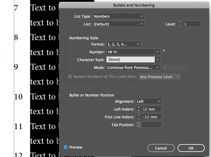

hammer0909
February 19, 2019
For the style that is formatting the Table of Contents entries, increase the left indent in the "Bullets and Numbering" options. Also set the "First line indent" value to the same value as the left indent but as a negative number.
