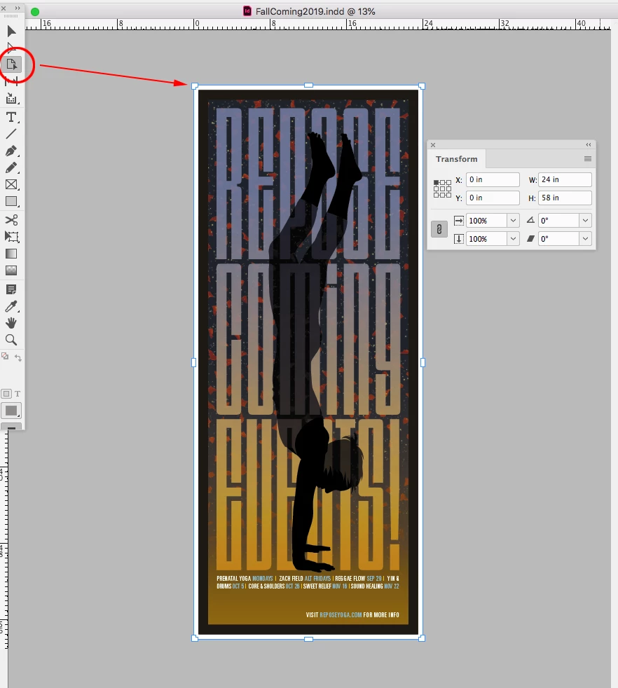

    Select the Page tool and use the Transform Panel to set the size:
    Use the panel‘s reference point to set which corner the dimension is adjusted from.
    I assume you are sending the doc to a large format printer. Why not export the page at 50% of its final print dimensions and have the printer output it at 200%?

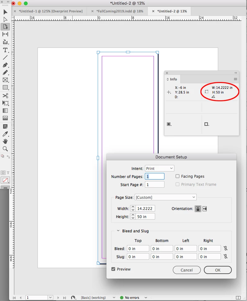

    the page itself is a very long narrow one - when I created it, I used a width of 1024px, and a length that I believe was around 11000 px, but I can't tell now, because when i got to 'Document Setup', it tells me that my page height is 3600px.
    Pixels are a static Ruler Unit in InDesign—you can change ruler units and get the equivalent dimensions of your page as Inches. Also the page size isn't necessarily the same as the Document Size—the Page tool lets you customize a page‘s dimensions.
    So here I have my Ruler Units set to Pixels, the Page tool is selected with the Info panel open, and the Document Size and page size are both 1024 x 3600 pixels.
    If I change my Ruler Units to Inches, I can see the page dimensions as inches—14.2222 x 50". If I export this page, Acrobat’s Document Properties would show the same inch dimensions.

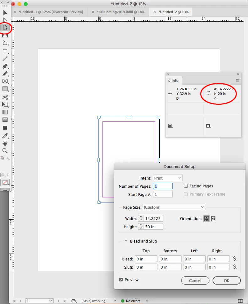

    But, I can also customize individual pages. Here the page size is different than the Document Size, and the Export will be to the custom dimension. Any page items on the pasteboard of this smaller page would get cropped on Export:
