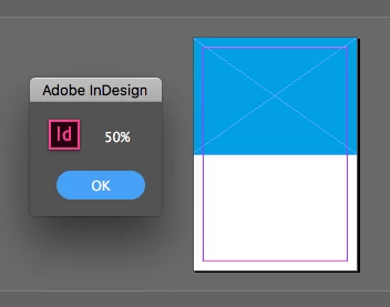

If a snap shot of the page was created as a png it might be possible to count the dots.
Edited.... Hmm, I like this idea. I going to write it. Not sure if it really fits the OP question.
