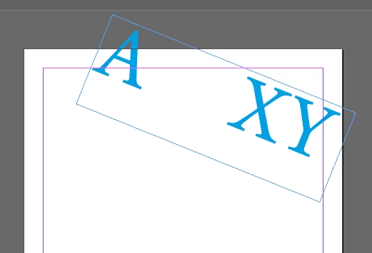

If a snap shot of the page was created as a png it might be possible to count the dots.
Edited.... Hmm, I like this idea. I going to write it. Not sure if it really fits the OP question.

April 1, 2023
Still - what margins ?
Hmmm, the margin is anyting over the pink lines. Currenly I am using this as a clipping path.
