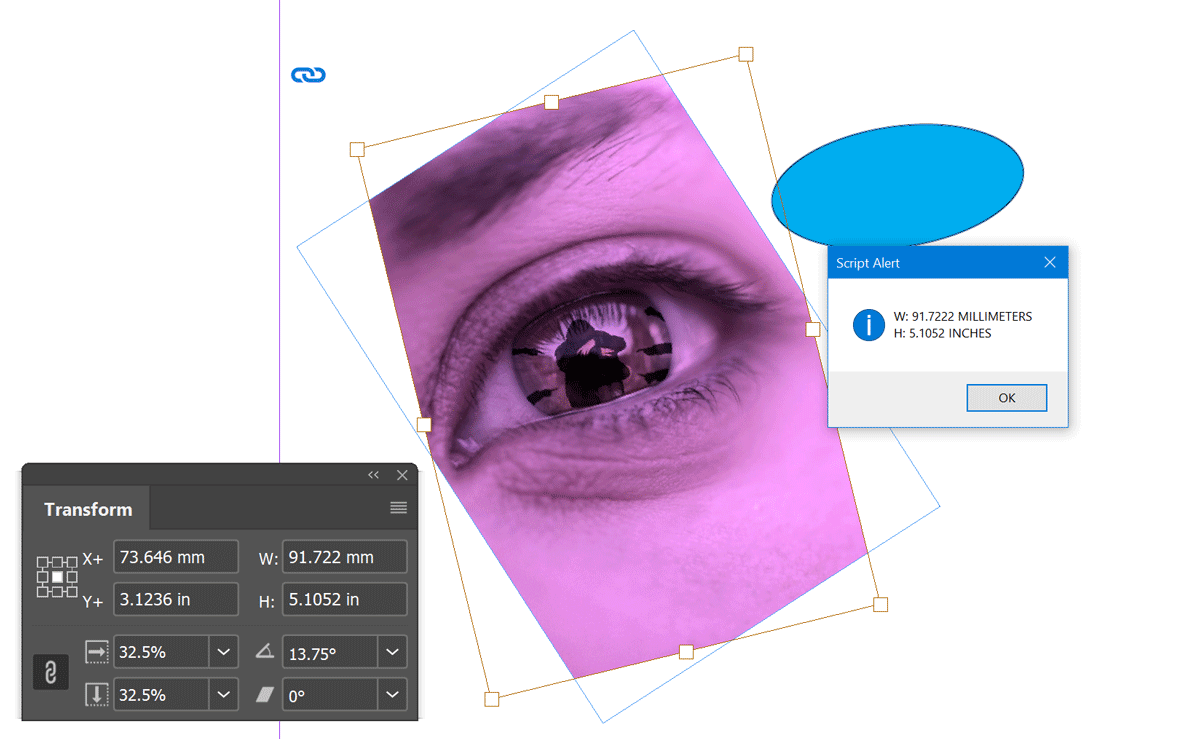

Hi @Chandrakanthi26574696ugut
To my knowledge, the dimensions shown in the Transform panel always reflect the size of the inner bounding box of the selected object — assuming a single object is selected — BUT with respect to the scale factor of the inner-to-pasteboard matrix and using the ruler units, so you get relevant values that fit the viewport.
In general you can't get reliable information from the geometricBounds property. But contrary to what was said above, it is possible to calculate these values from transformation states, including for internal objects like Images, etc, which would not fit their container.
Also, the preference Dimensions Include Stroke Weight impacts the displayed dimensions, which can also be taken into account by the script.
I have just written the code below as a first sketch (not tested it in all possible conditions but gives fairly satisfactory results):

Animation shows script behavior with various cases of (nested, rotated…) selection:
I don't remember how the shear attribute is dealt with in the transform panel. This scenario might require a small adjustment of the proposed code… if you really need it.
Hope that helps.

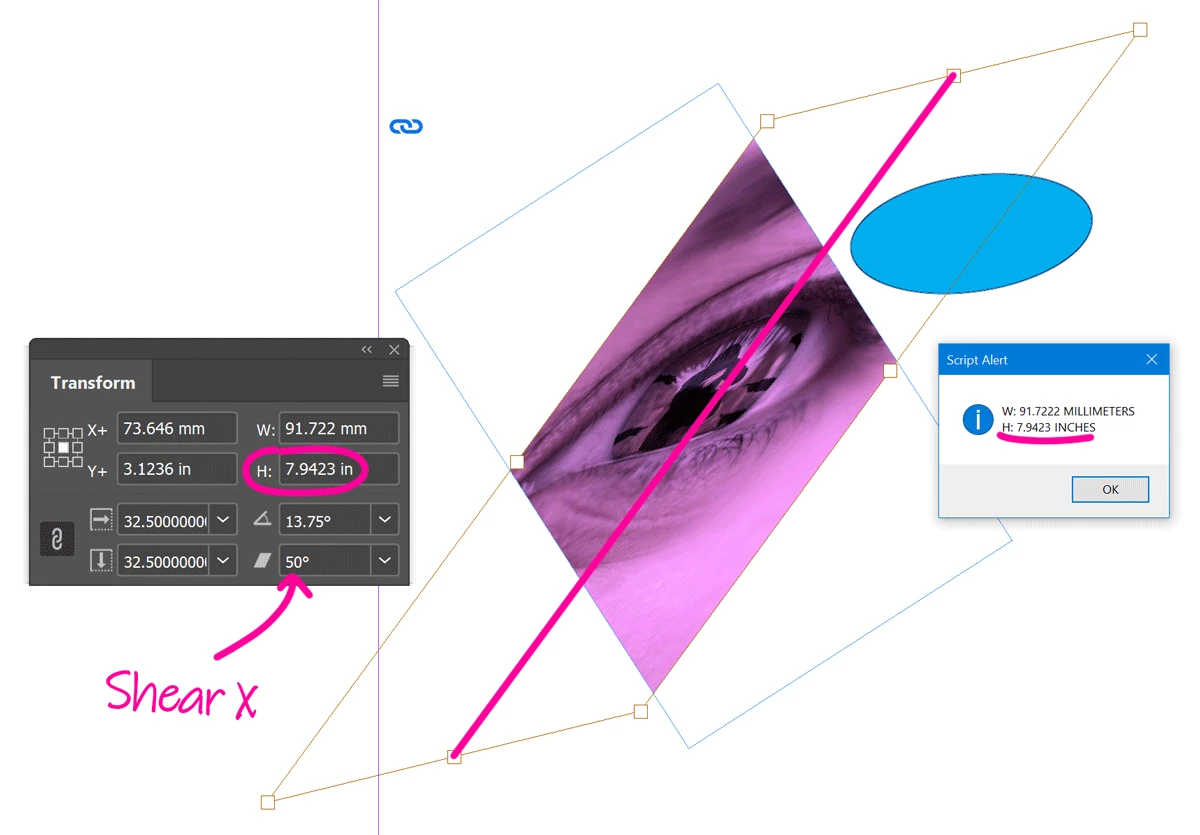

Marc Autret
January 9, 2024
[In addition to my previous message]
When a Shear X angle α is applied, the displayed height is updated accordingly (while width is not impacted), so we must divide h by cosα, where α ranges in ]-π/2,+π/2[. This leads to the fix below:

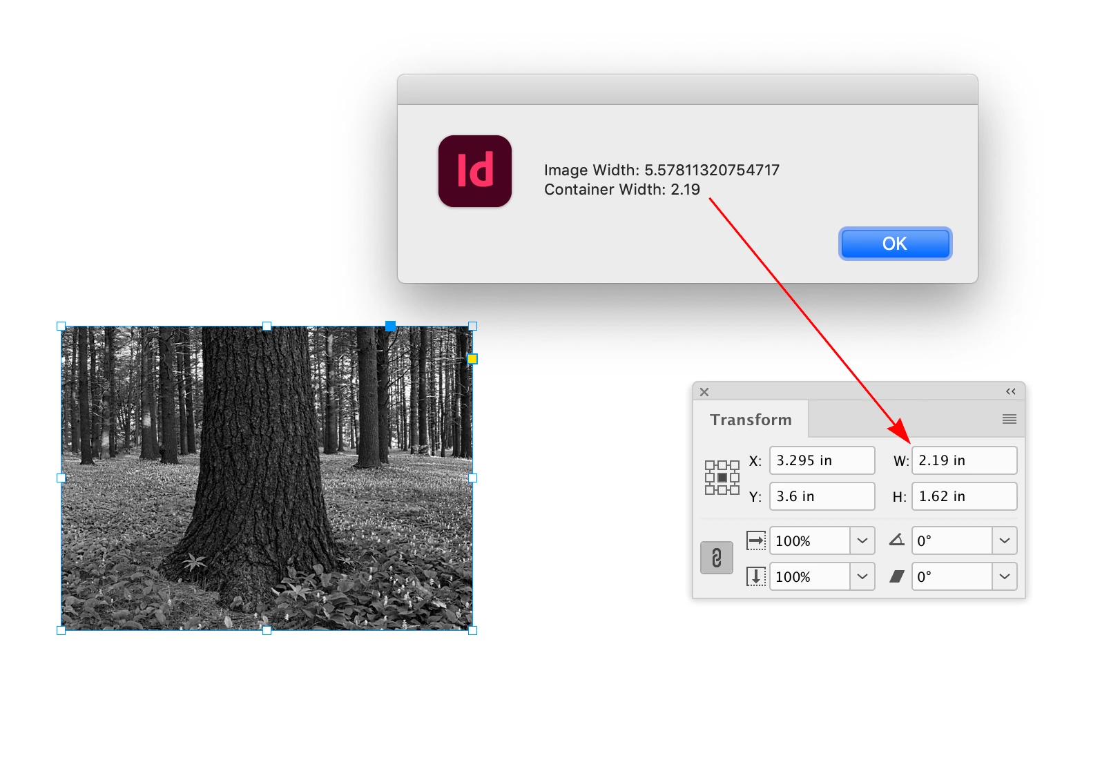

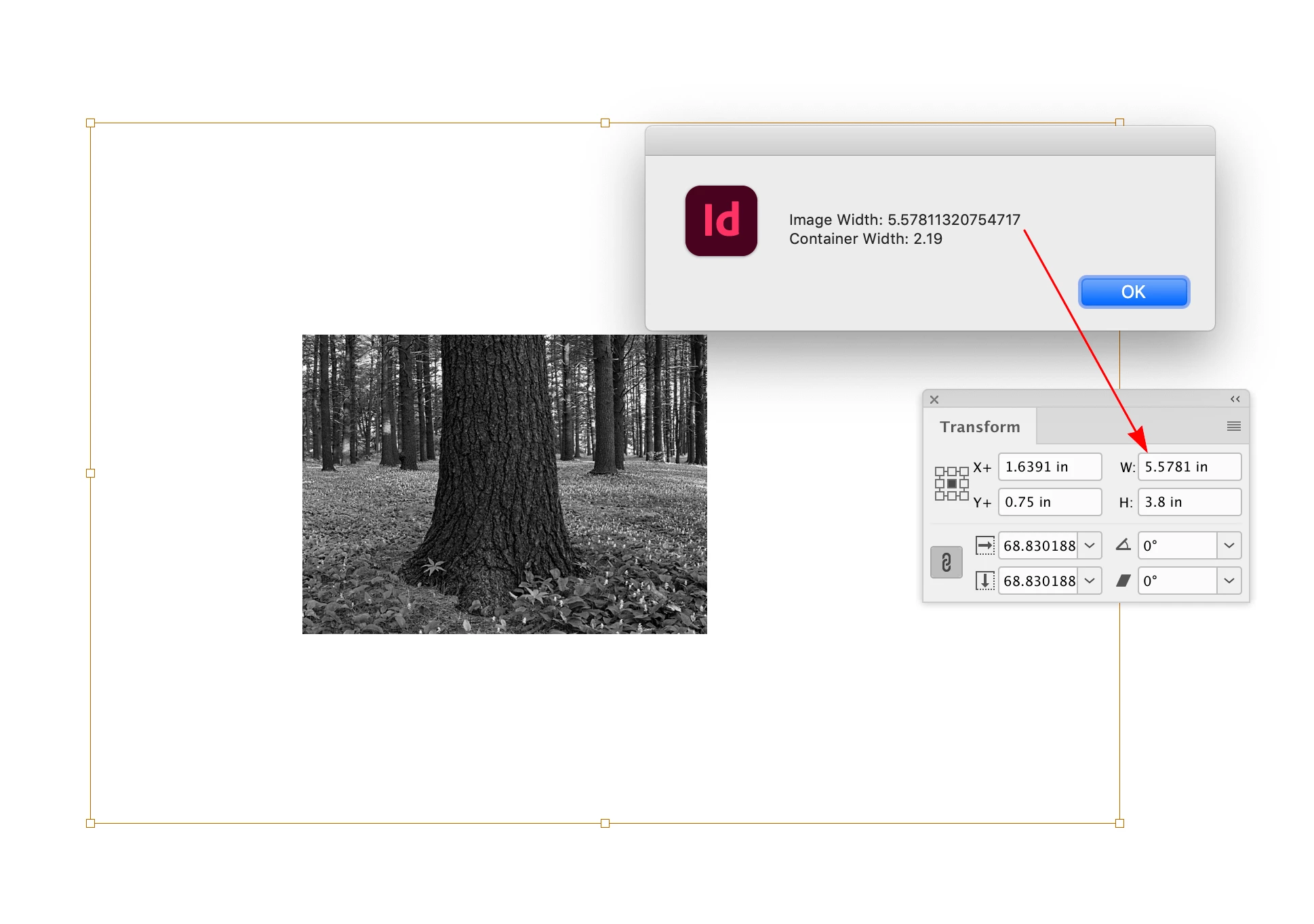

But what are you selecting to check the Transform panel Width?
For example this gets both the linked image width and its container frame width, which is what‘s showing in the Transform panel when I select the frame :
var lnks = app.documents[0].links;
//an image, the link’s parent
var img = lnks[0].parent
//the image bounds and width
var ib = img.geometricBounds
var iw = ib[3]-ib[1]
//the image’s parent container frame bounds and width
var fb = img.parent.geometricBounds
var fw = fb[3]-fb[1]
alert("\rImage Width: " + iw + "\r" + "Container Width: " + fw)
The image direct selected:
