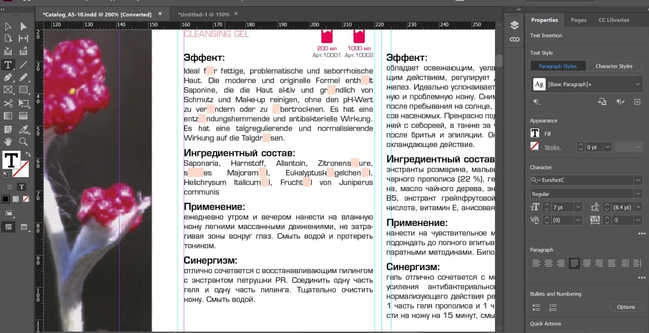

Hi everyone. While I was translating russian texts to german , I had a bug.
I pasted needed text , but some german letters like ö, ä, ü are apppears as you can see in the picture.?
I was using inDesign CC 2018, but then I installed inDesign 2021 . However, not worked. Who faced same problem like this?

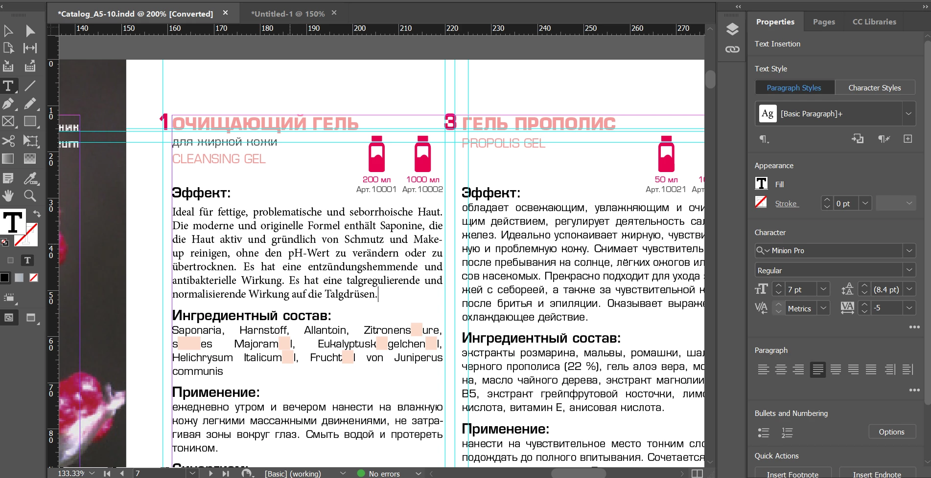

Well, that font EurofontC is a Cyrillic knock-off of Eurostile. You could replace it with real Eurostile (which most certainly has the u-with-umlaut) and there'd be no visual difference. However, if your client has insisted that you use EurofontC, then a) your client is a fool, and b) you're going to have to use some pretty poor techniques to fake up those umlauts. These techniques are really fragile (composition by a simple change in font size! among dozens of other potential flaws) so maybe you'd be better off doing pretty much anything else:
However, once you've made this monstrosity, you can copy it to the clipboard and replace all properly encoded u-with-umlauts with "Clipboard Contents, Formatted" and all you'd have to do would be to correct the post-umlaut kerning. I still think that the only way forward is to use a different font, but You Do You (or what your client wants, if that's what you have ot do).

A pink highlight means that glyphs are missing, but that strange since these glyphs are very common. What font do you use?

Thanks for replying. I am using font that called ' EuroFontC ' .

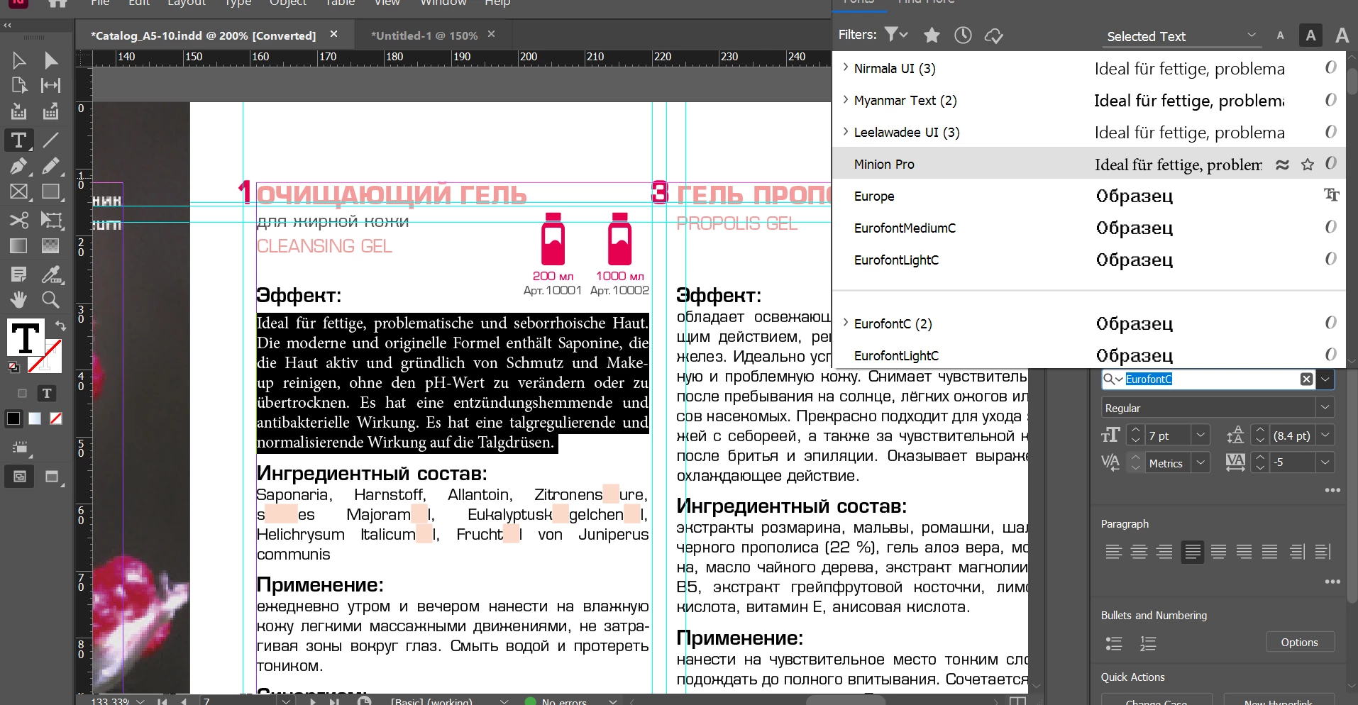

But when I changed the selected text font another one , it looks pretty correct.
And Pink colours disappear.
How can I appear the hidden signs not using anather font.
So it means that the ü, ä, ö glyphs do not exist in this font. What do you see in the glyph ânel when you select one of the highlighted character?
It will not be possible if the glyphs are missing.
