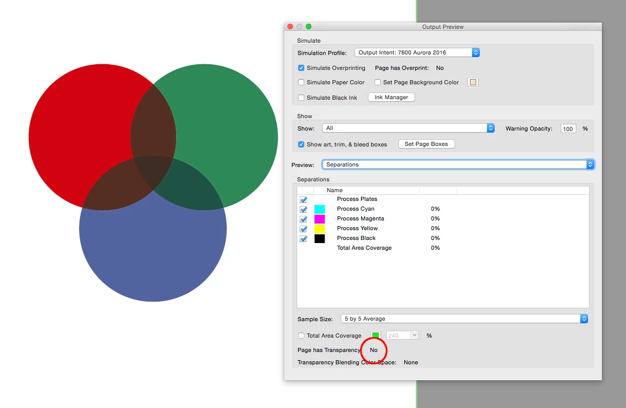

You can use AcrobatPro's preflight to check for transparency. Tools>Print Production>Preflight>PDF/Compliance. Choose a profile and click Analyze.
Output Preview panel will also tell you if there is transparency on the page:
