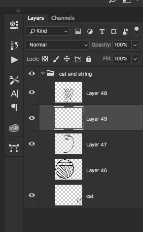

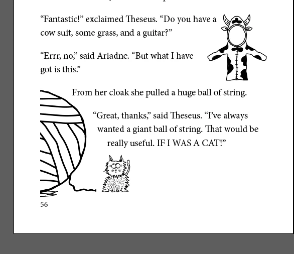

All the illustrations in the book are simple black line drawings done in Photoshop.  (examples below) All the pictures where placed into my CC library and then placed into Indesign from there. Several of them have layers, but they don't have any effects such as drop shadow or glow.

Example of pictures in book (from indesign) and how the layers look (from Photoshop)

you'll see the transparency warning in the moment you place PhotoShop files with an additional layer to the background layer that is not flattened. That implies and introduces transparency to an InDesign document. Even if it is one "normal" layer and no pixels are actually transparent.

Convert to Grayscale and on to 1-Bit bitmap and save as tiff.
Then all drawing pixels come in with swatch [Black] when placed with InDesign and all non-drawing ones simply are "not there". This is looking like "transparency", but it does not invoke the transparency warning.
You can color the 1-Bit bitmap with InDesign. If you leave it with swatch [Black] make sure you set the image to overprint if you use it stacked above a colored background.
