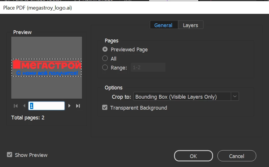

Workaround, without getting editable paths:
Place the Illustrator file on the page.
Enable Placing Options and use the option:
[x] Transparent Background.

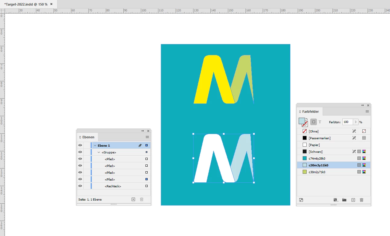

Hi NitroPress,
I'm on Windows 10, working with InDesign 2022 and Illustrator 2022.
Maybe I'm doing something wrong? I cannot get transparency from pasted Illustrator elements.
Below my sample test in details.

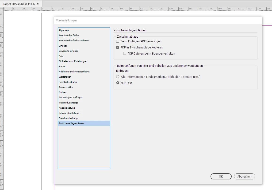

InDesign's clipboard preferences:

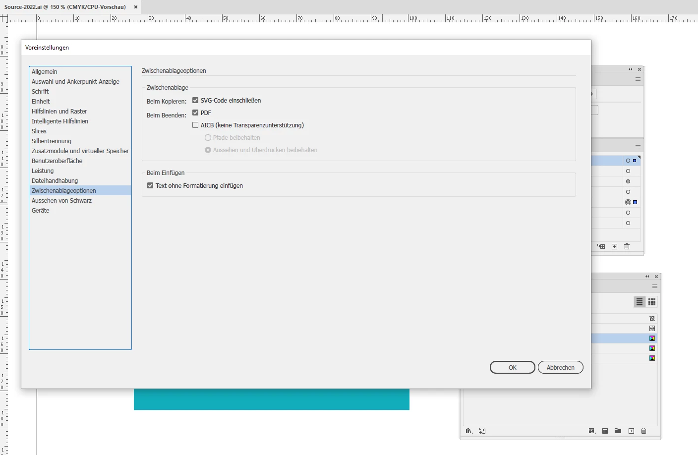

Illustrator's clipboard preferences:

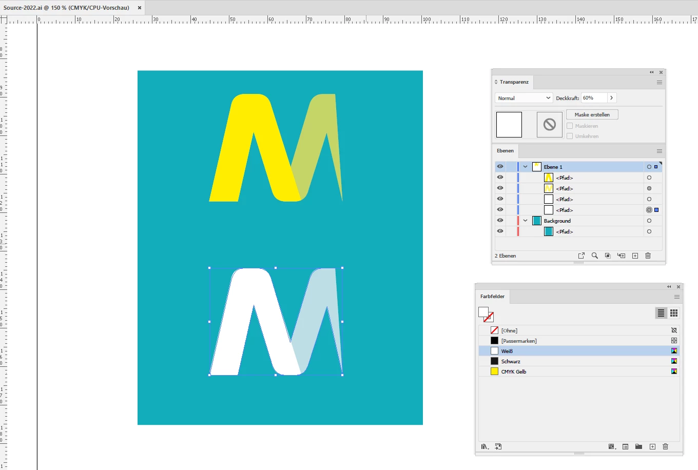

Sample objects selected in Illustrator:

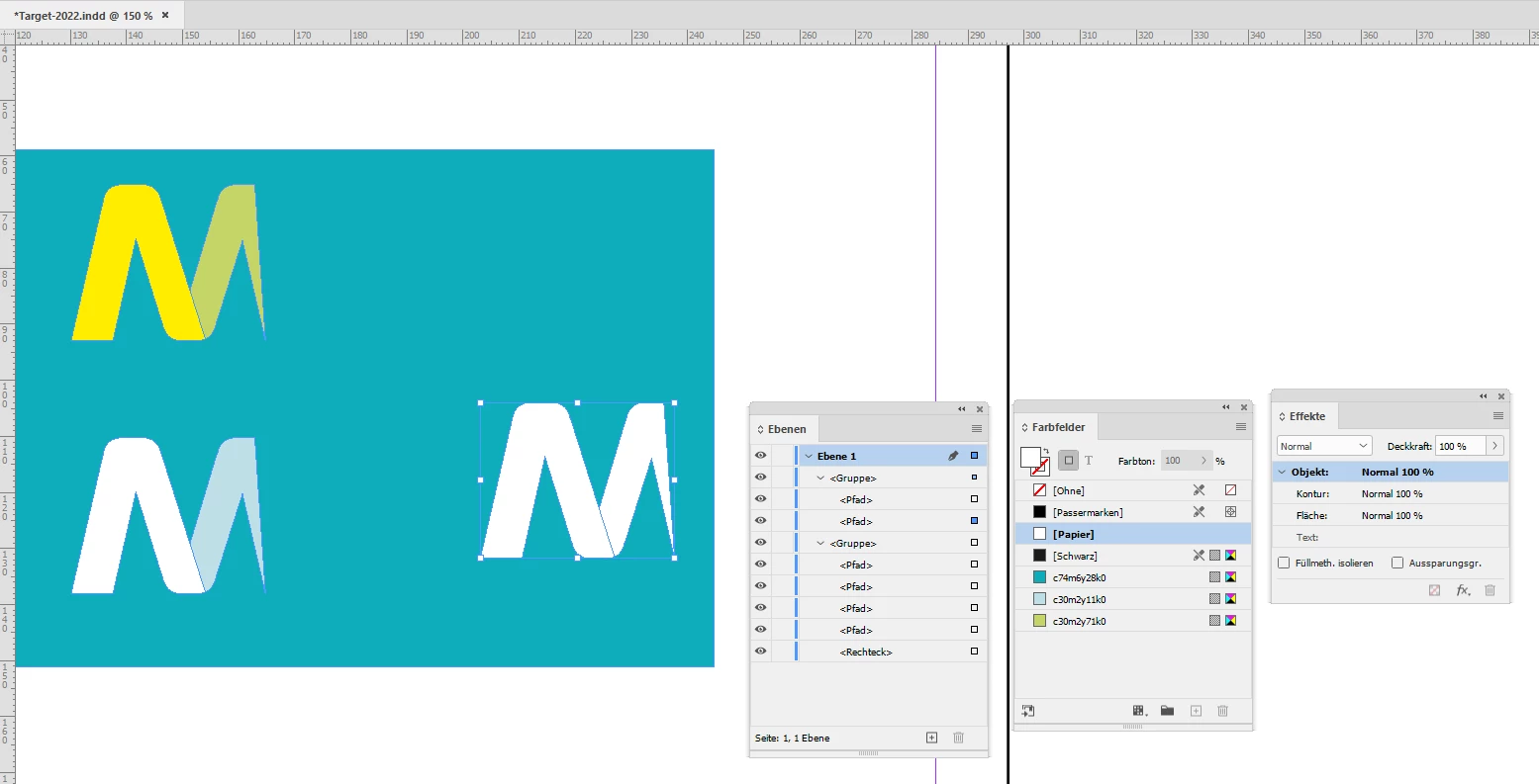

Pasted result selected in InDesign, no transparency.
Transparency is only simulated by using different fill colors:
If you only copy/paste the element with the [Paper] fill from Illustrator to InDesign without its background element, InDesign cannot simulate a given background from the contents of the clipboard, so the pasted result remains with fill color [Paper]:

hutts72 said: "Is anyone having issues when pasting transparent vectors from illustrator into Indesign 17.2?
Opacity seems to be removed altogether."
Hi hutts72,
yes. I can see this as well. Tested with a transparent element with fill color [Paper] copied from Adobe Illustrator 2022 to InDesign 2022 version 17.1 on Windows 10.
"This workflow has been successful with previous versions."
I'm not sure at all if this ever worked for me.
At least not if editable paths were created after pasting the clipboard's contents to an InDesign page. Elements were never copied over with transparency applied. But what I did see: Embedded graphics of PDF type as a result when the complexity was too high for example. But editable vector paths with a fill color and transparency applied? I don't think so…

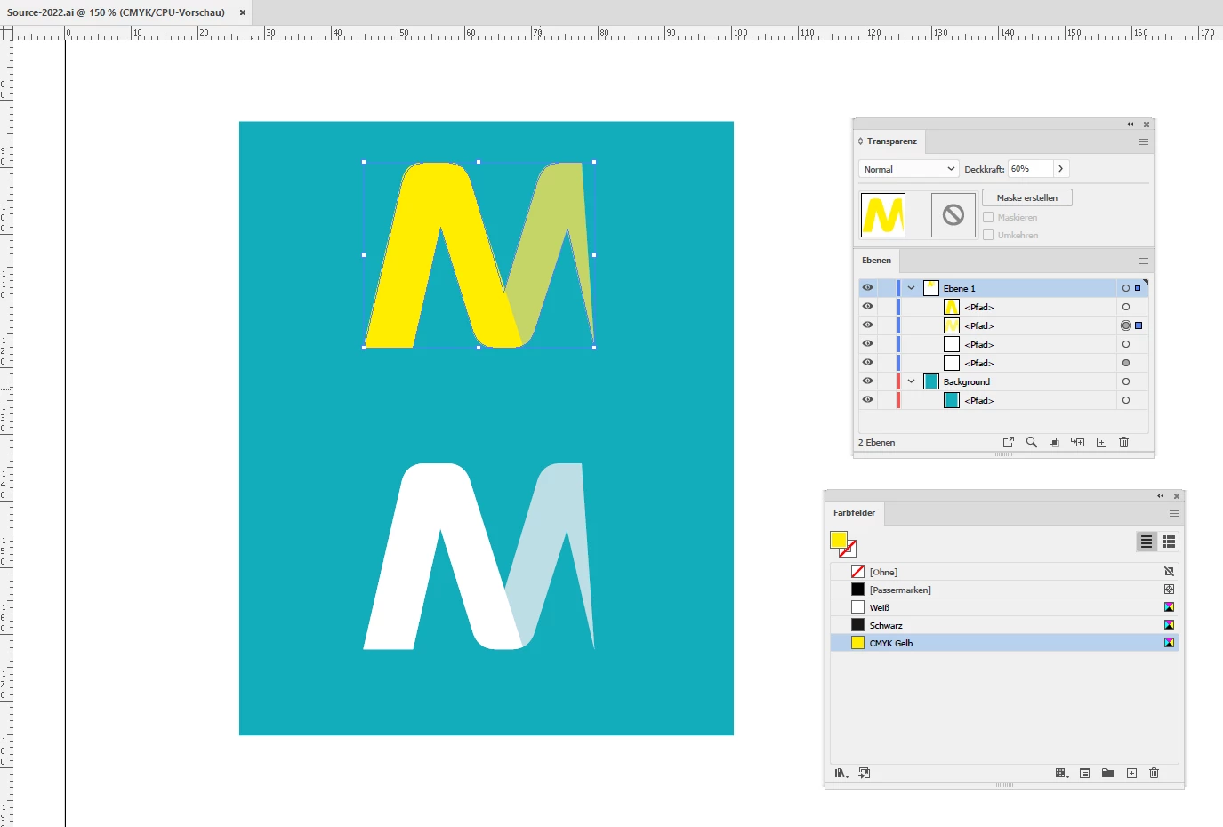

What worked:
If you change the fill color of the transparent object in Illustrator from [Paper] to e.g. 100% CMYK Yellow, then the pasted result in InDesign simulates transparency like opacity 60% with a fill color of 60% Yellow. Real transparency is not maintained in the result.
Uwe Laubender
( ACP )
