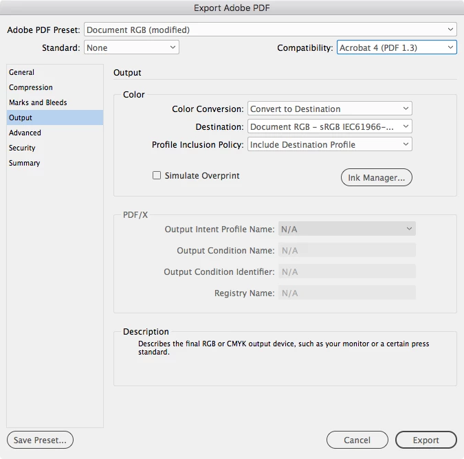

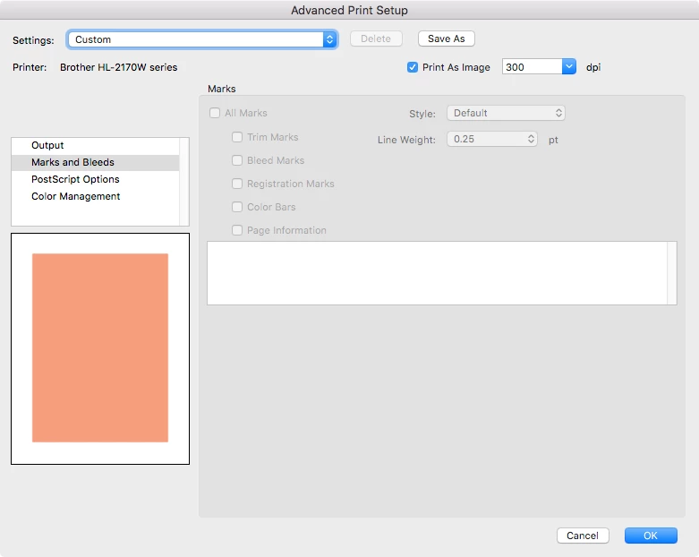

It can be a common problem with composite printers and transparency flattening—print drivers don’t always correctly color manage and flatten transparency. The solution that usually works for composite printing is to export a flattened RGB PDF and print that as an image in Acrobat:
Set the Output to convert to Document RGB with the Compatibility set to Acrobat 4
Click Advanced and check Print As Image
Feb 16, 2024 12:29 AM UTC
Thank you, this worked a treat!
