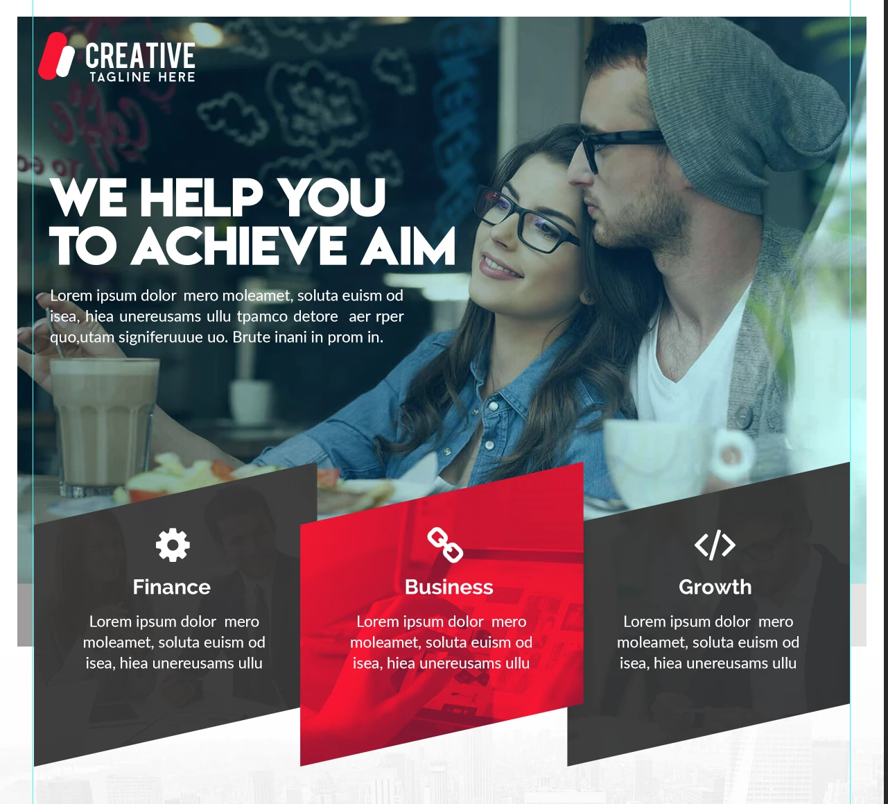

Aug 20, 2018 9:41 AM UTC
Derek Cross
Aug 20, 2018 9:52 AM UTC
Assuming the trim marks trim the flyer to A4 this seems OK, although a little more space (margin) on the left and right would look a bit better IMO, in other words bring the content in a little. Also make sure the type layers are the first ones. Other comments (subjective), I'd make the headline a bit larger and move the shadow closer to the lettering and make the line spacing a bit closer.
Aug 20, 2018 11:52 AM UTC
Thank you so much. I have done as you suggested and moved everything closer to the centre. So 6 mm margin is good?

Aug 18, 2018 1:11 PM UTC
Thanks I might just leave it the way it is then. Don't want to risk. Thanks for your help!
Aug 18, 2018 4:19 AM UTC
Thanks so much for your help. I have now redone most of the flyer in Indesign.
Now I have a couple more questions..
1. How can I achieve the same effect (clipping mask in PS) like on the provided example. (photo on top of the rectangles with low opacity). Do I have to duplicate the shapes?
2. If I want a white border for the top photo, do I need to make sure that the photo is not going over the margins?
Many thanks
BobLevine
Aug 18, 2018 11:05 AM UTC
You can knock the opacity back with the effects panel.
The shapes can be drawn using the rectangle tool and the shear tool.
Keep the white frame in the safe area, but I warn you, if the flyer isn't cut perfectly centered, it's not going look right.
