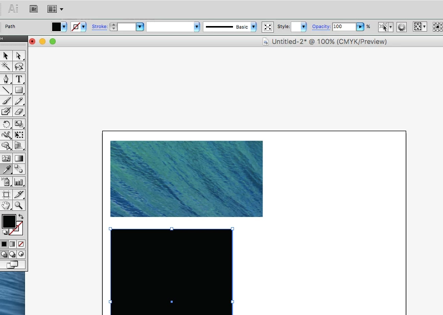

Anyone have this resolved? Using Mac Air Sierra illustrator cs5 and getting a similar problem (just happened all of a sudden?). Am using the eyedropper tool to try take shades of the pdf and no matter what colour I'm trying to sample, it just gives the same greeny/blacky colour. Here is a example below. So taking a screenshot of the the mac background to get the shade of blue, however when using eyedropper tool to make the square black, it just gives the same colour!

The problem is you have "appearance" enabled as part of the sampling. To fix this do the following:
Double click on the Eye dropper tool, and uncheck "Appearance" in the Eye Dropper Picks up section.
It's a bug I think and it should be fixed when you are sampling color from images.
