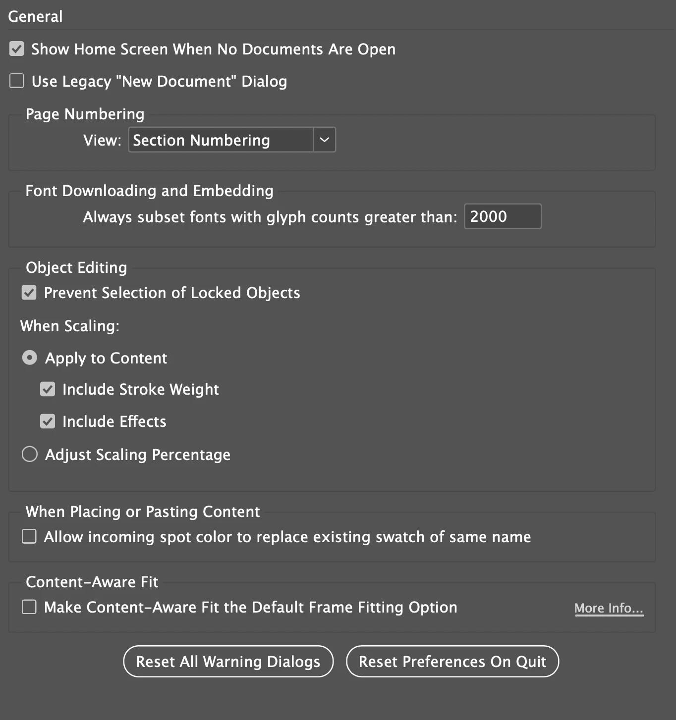

In InDesign > Preferences > General > When Placing or Pasting Content > ... what is that switch set to? Allow or don't allow?

None of the boxes in the "when placing or pasting content" are checked.
