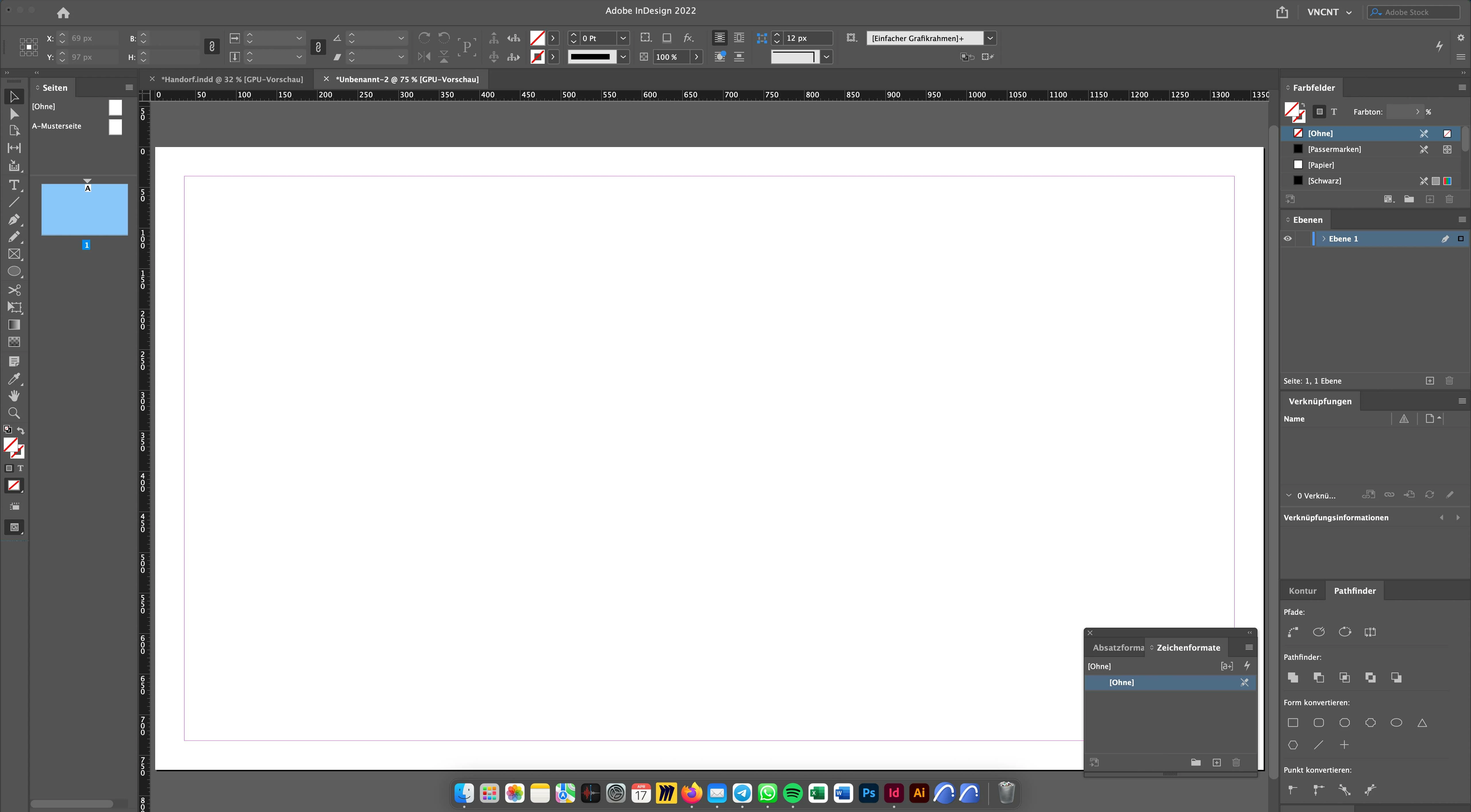

CARLA_STNAuthor
Apr 17, 2022 7:30 PM UTC
Hi Steve,
Thanks for your quick reply. I think I expressed myself a bit difficult and would just upload two pictures (before/after).
1) Before (pic 1) = The Indesign window is simply scaled to 50% of the screen size (to make the porblem clear).
2) I press SHIFT + W (sorry, I got the shortcut wrong!). This switches me to presentation mode.
3) When I leave the presentation mode to continue working on the document, the result is that the Indesign window fills the whole screen (see picture 2).
System=
iMac 2017 – MacMonterey 12.3.1
InDesign=
InDesign 2022 Version 17.2
