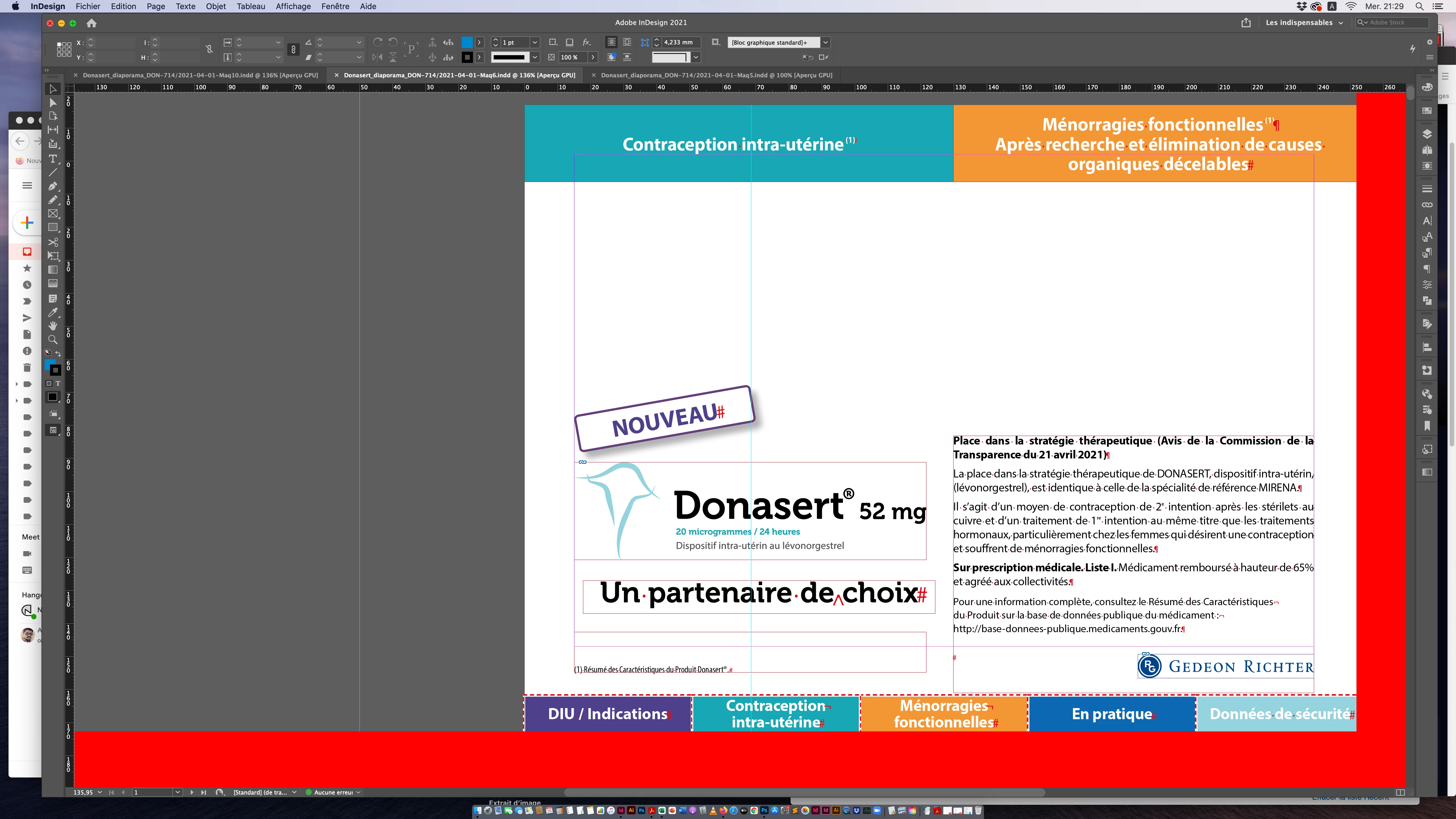

Todday I mayde some changes on a file and the picture on my file disapeared, I didn't notice because I was concentrated on the chagnes, but my client is furious.
Beside that when I reopen the old version of the file and it  was framed with red line! What is it??
Indesign version 2021 is not stable AT ALL, I had some other issues; typo not mounting, registering in IDML changing the set up of the pages...

Comme l'a écrit Derek, il faut désactiver le GPU dans les préférences > performances GPU. C'est un bug connu de cette version.

Iresolved the issue by placing the image again on the file, but my point is that this issue should never happened in the first place! If you work on a poster you will notice the trouble but on a 30 pager or more??????

Looks like an issue with your graphics card, try unticking in InDesign preferences under the GPU Performance tab, GPU Performance.
