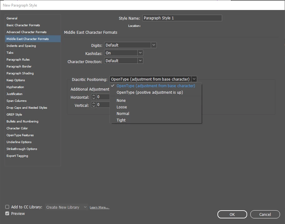

If that's not the case, then if you were to post an InDesign INDD file with a snippet of poorly behaving text, it might take us fewer posts to figure out exactly what is going on. I have a few suspicions, though. I can see that you're using CS6 with an InTools plugin... is it WorldTools? I've not used WorldTools in a very long time, so I can't recall whether or not it has an "OpenType Diacritic Positioning" preference. If you were using Creative Cloud, you could install a version of InDesign that has a complete set of RTL tools, and then you could find the preference in your Paragraph Style right here:
