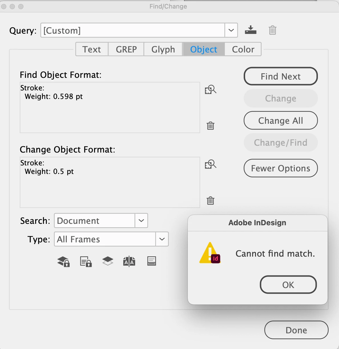

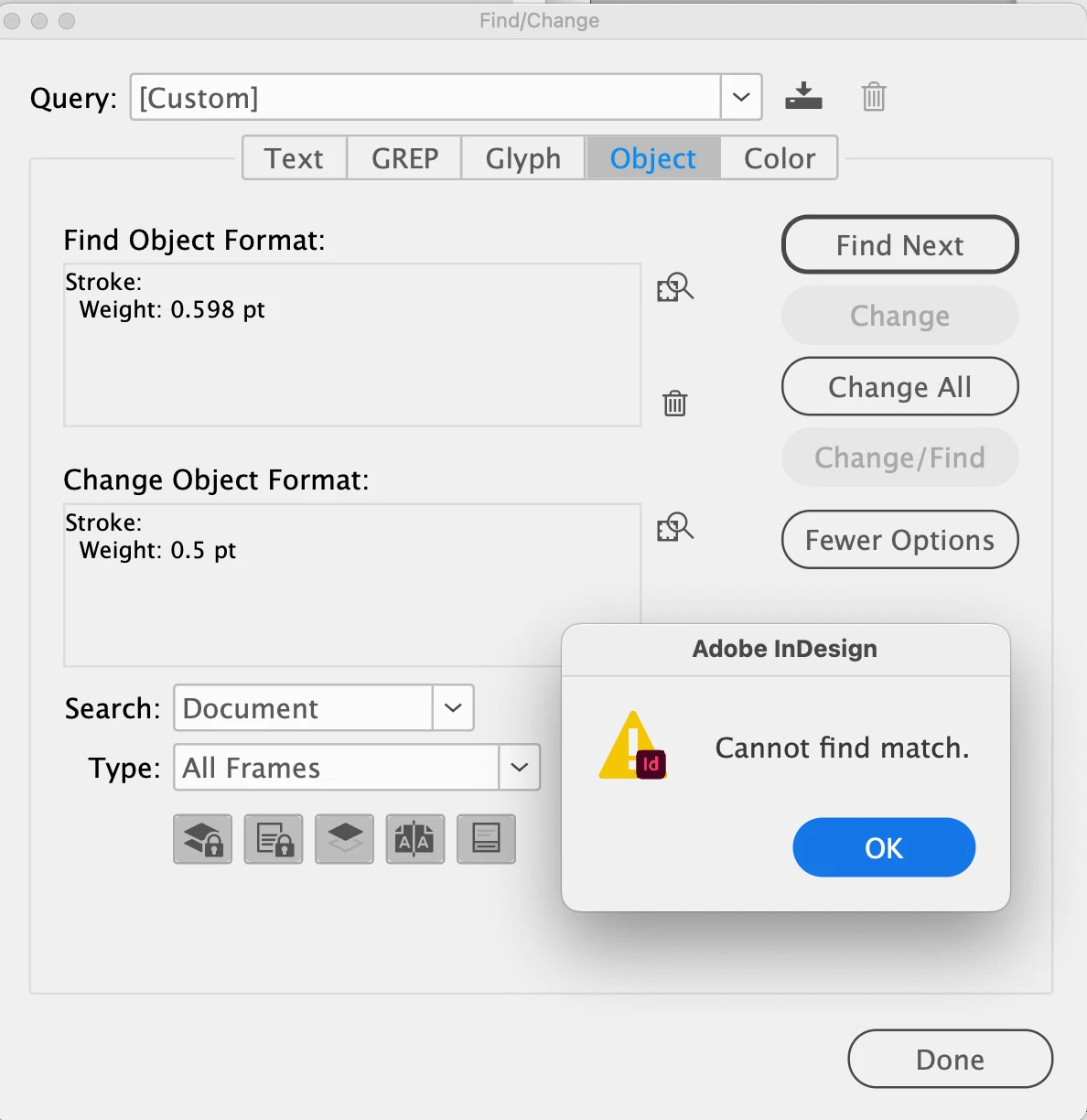

I have a multipage document with many .598 strokes/rules. I want to change them all to .5. I tried using Find/Change Object but keep getting a "Cannot find match" message.
I tried it with a full description of the strokes (color, type, weight, etc.), and then with just narrowing it down to the stroke weight. Nothing is locked or in alternate layers. The attached screen shots show my current attempt. Any thoughts as to what I'm doing wrong?

I can only guess that InDesign only shows you three decimal digits of the stroke weight, while the actual value has much higher accuracy (e.g. .5983126254). If you share the file, as @Mike Witherell mentioned, we can check the actual stroke weight via scripts.
LauraFigAuthor
Jul 24, 2025 2:27 PM UTC
I did a test creating a custom 3 digit stroke--no problem finding it-- so you are correct! I've attached a test file with just the original stroke in question. If you can determine the actual weight, that would be awesome!

Yes the actual stroke weight is 0.597949092147
