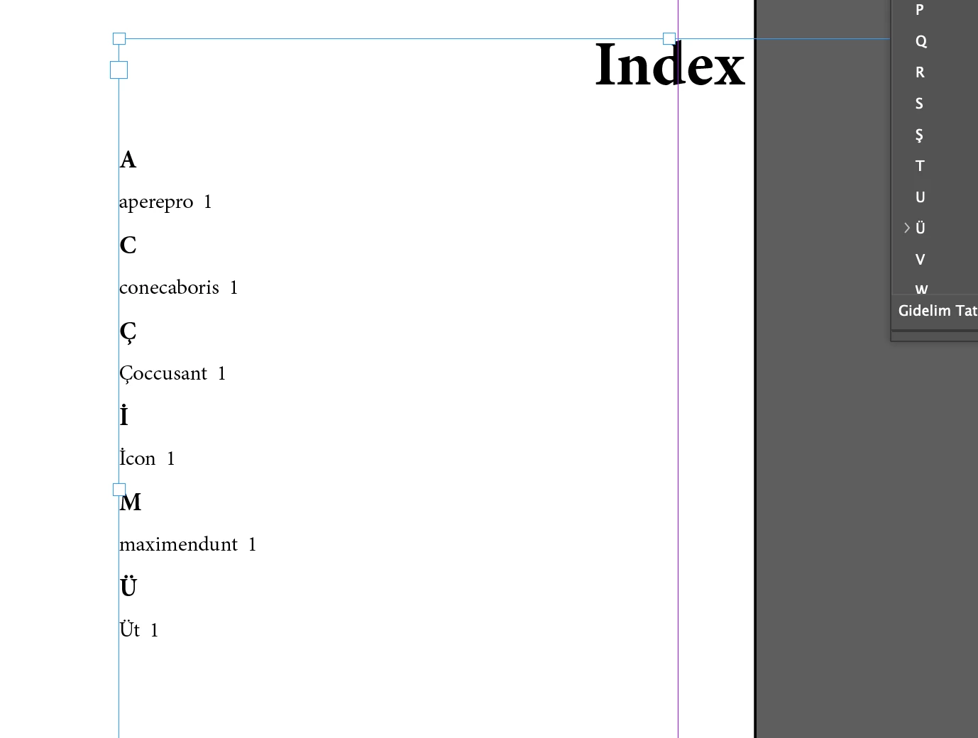

Thank you for your interest,
@1287334at ID-Tasker and @Laubender. Since the project consists of a large amount of content, I prepared it as a book, and as of last midnight, I finalized it. However, the issue wasn’t resolved, so I had to manually intervene in a section of the index (I did this within the INDD file using the 'SortParagraphs.jsx' script).
The interesting part is this: When I opened a blank document for testing, I actually saw that the system worked perfectly fine. I’m attaching a visual related to this. Additionally, there’s another oddity in the document I’m working on: in the index sorting, Turkish characters are mixed up in Level 1 topics, while they are sorted correctly in Level 2 topics.
In this case, there seem to be two possibilities:
1- Perhaps I made a mistake while entering the index entries (I checked twice, but I didn’t see any issues).
2- Maybe there’s a bug in the program, and this issue occurs when working with a "book."
Since the index structure is very long (consisting of approximately 5,000 independent entries), I honestly don’t have the courage to start from scratch. After delivering the current project without issues, I plan to create a simple document and run a few tests to investigate this further.

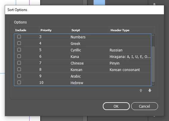

Mar 27, 2025 3:20 PM UTC
Thank you for your response! I understand your point about InDesign’s sorting primarily working with English letters and not handling diacritics by default. However, I’d like to share some additional details about my situation that might shed more light on the issue.
In a test document I created, I was able to get the Turkish sorting to work correctly. After setting the "Sort Options" to "Turkish" in the Index panel (Window > Utilities > Index > Sort Options), the generated index showed the "Ç" entries under a separate "Ç" section heading, as expected in the Turkish alphabet. This suggests that InDesign does support Turkish sorting when the correct settings are applied.
However, in my main document, the same settings don’t seem to work. Even though the Index panel shows the "Ç" entries correctly under a "Ç" section, when I generate the index using the "Generate Index" dialog, the "Ç" section heading disappears, and all "Ç" entries (e.g., "Çağrı", "Çay bahçeleri") are listed under the "C" section, mixed with "C" entries (e.g., "Cam", "Ceviz").
I’ve also checked the level definitions (Level 1 and Level 2) in the Index panel. For example, "Çağrı" is defined as a Level 1 entry, and it appears correctly under the "Ç" section in the Index panel. But this structure doesn’t carry over to the generated index in my main document.
Robert at ID-Tasker
Mar 27, 2025 3:30 PM UTC
Right, sorry, I've confused it with Bullets and Numbering.
How did you get Turkish on the list?
