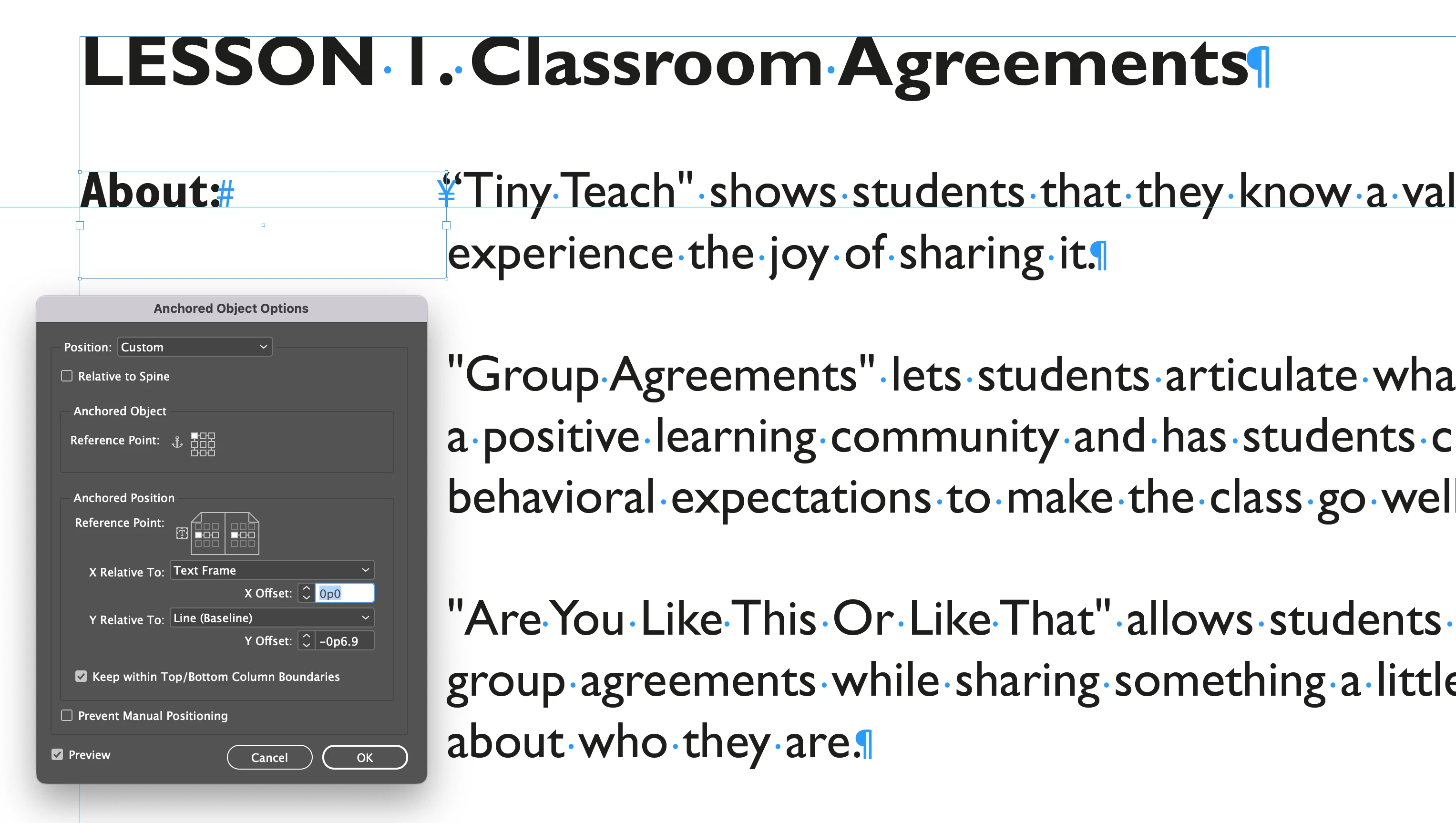

Thanks a lot for your comments and great help. I made typesetting using headlines as Anchored Objects using Find/Change. It was the pretty easy way. I also tried this method https://graphicdesign.stackexchange.com/questions/145597/indesign-best-practice-for-headings-in-separate-columns. But it's more complicated.

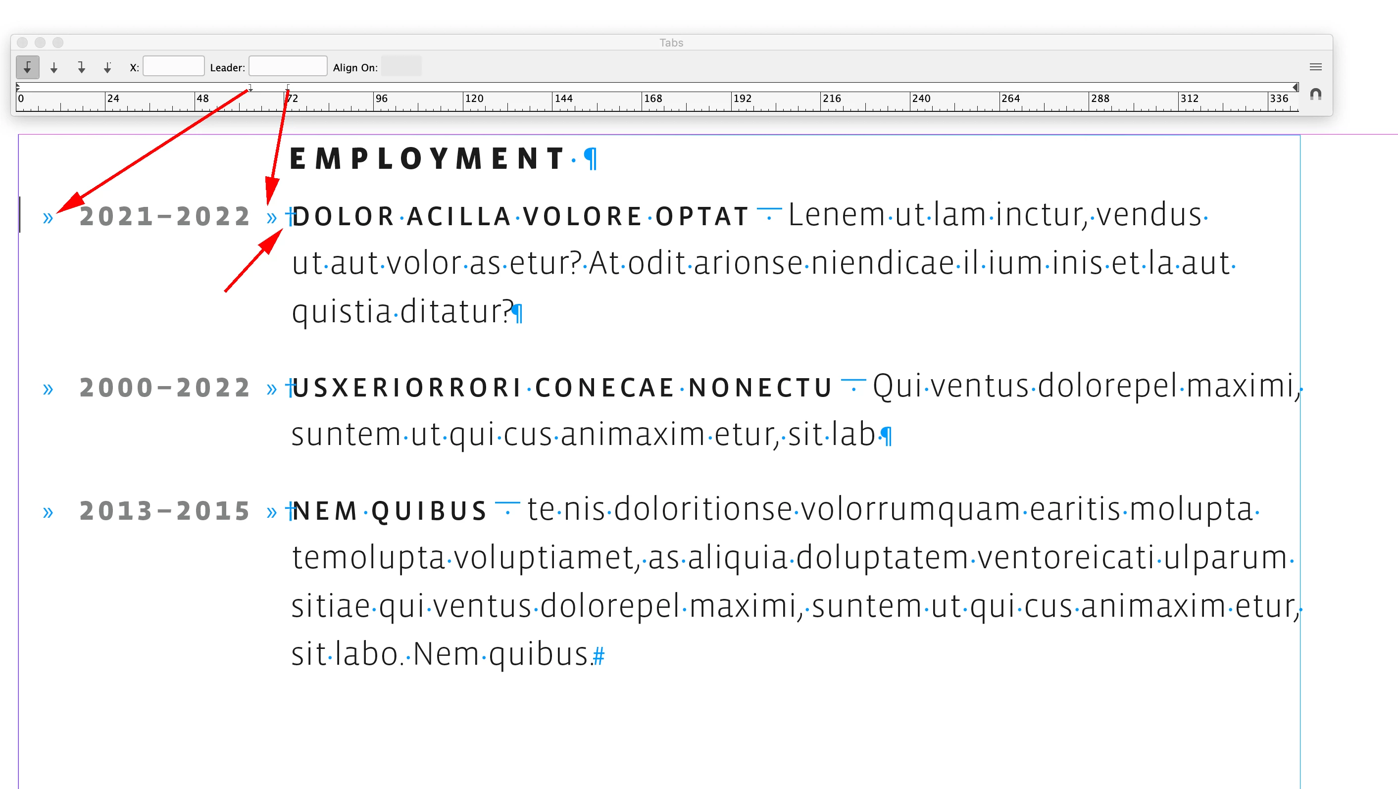

Hi @oksananka , there’s also Intent to Here (Type>Insert Special Character>Other>Intent to Here), which would let you set the two "columns" in a one column text frame.
Here I’ve set a Right Justified Tab, followed by the "Column 1" text,  a Left Justified tab, an Intent to Here marker, and then the "Column 2" text :
EDIT: This only works when the left "column" is 1 line .

I used an anchored text frame for the text on the left. Normal text has a left margin. The anchored object options position the text frame where I want it so the baseline of the first line lines up with the body copy. Making the anchored text frame an object style makes it weasy to globally change all subheads.
I think this is a lot easier than working with tables. Tables are fine for tables, but terrible for body copy, especially for a long document.

Setting the side headlines as Anchored Objects could work. If the length of the text on the right changes, the text frame containing the headline will follow the paragraph up or down the page.
