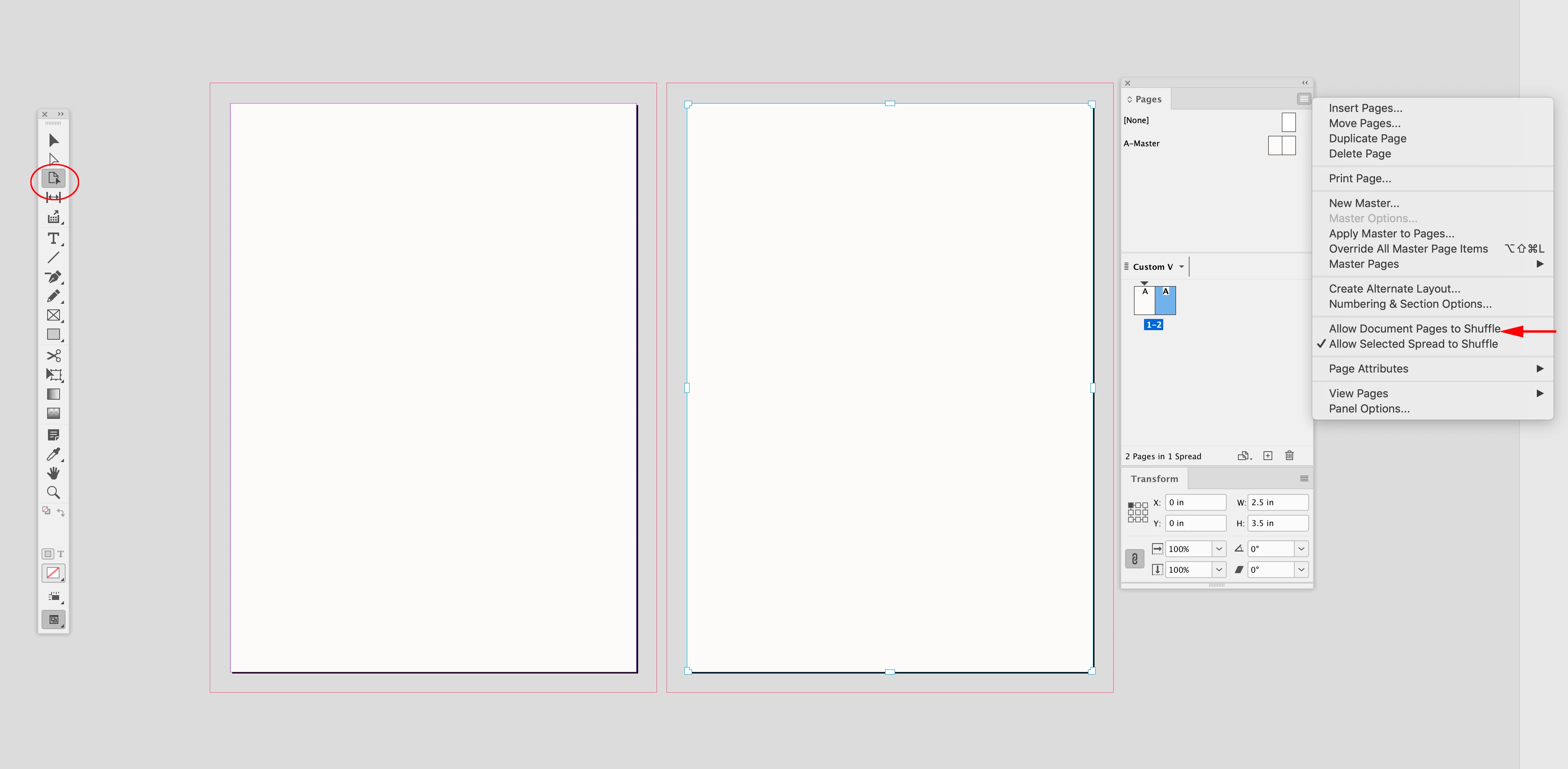

Thanks guys - I tried Rob's method, but it doesn't seem like threaded text frames want to behave-
Allow Shuffle needs to be re-checked when text is flowed in threaded frames in order to not populate a spread with more pages, but reverting to Shuffle creates single additional pages rather than spreads.
Hmmm.... still experimenting...

I think Rob's method is probably simpler than mine...
Peter Spier
Aug 6, 2025 5:44 PM UTC
If I understand waht you are doing, you should be able to set up single pages, rather than facing.
Add your bleed, then go to the Pages Panel and reset the number of pages on Parent A from 1 to 2, and use the Page tool to move them apart enough for the bleed in the gutter.
In the Documents pages section, turn off page shuffling and rag every other pagenaxt to its parner until you see the little vertical line indicating they will display as a single spread, and again use the page tool to create enough gap at the gutter.
Yoou should be able to thread text across the pages any way you like.
rob day
Aug 6, 2025 5:42 PM UTC
Hi @turner111 , A facing page document assumes the spread will fold on the spine. You are not designing a book, so you can set up the cards as non facing pages. Uncheck Allow Document Pages to Shuffle and the spreads can then be pulled apart—see attached sample.
