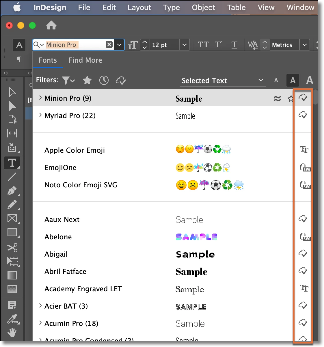

You can see the type of fonts you have installed by examining the right column in the fonts list. All of the Adobe fonts that come with your CC subscription (cloud icon or O) are OpenType fonts. TT designates TrueType. You will see a T1 by the Type 1 fonts. I don't have any installed at this point so I can't show you one in my list. Specialty fonts come in all varieties. For classroom lessons they can use whatever they like. For professional print jobs I'd encourage the use of OpenType fonts.

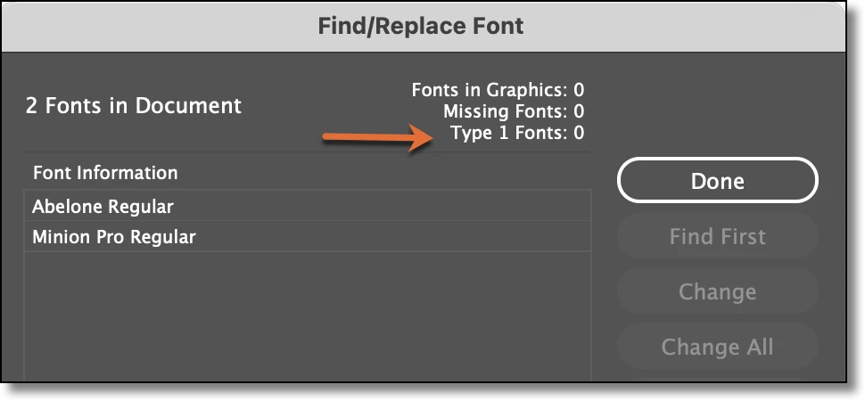

You can check an existing document for Type 1 fonts by opening Type > Find/Replace Fonts.

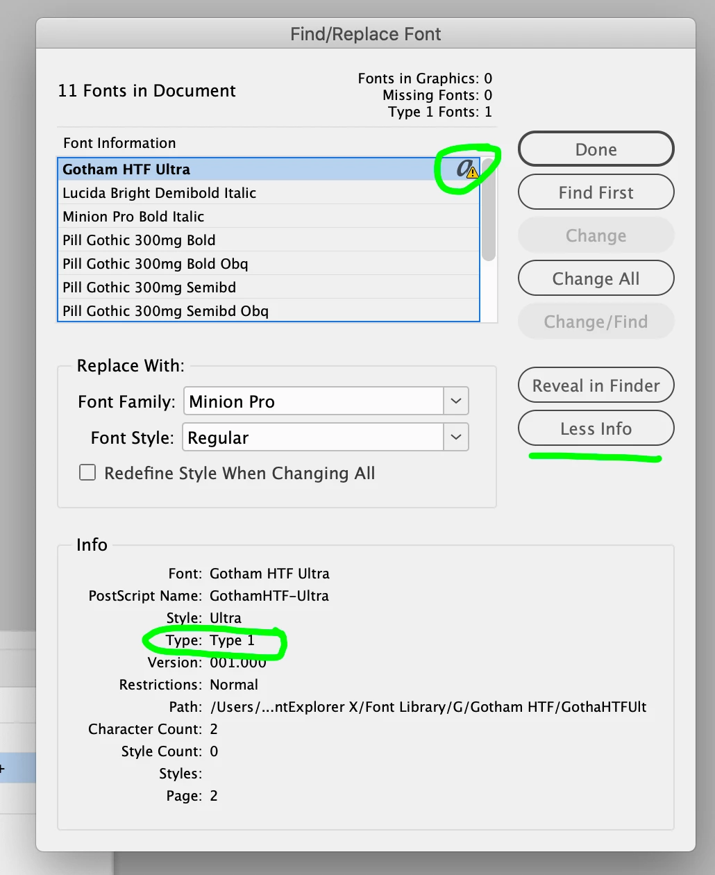

2) You can also just check in InDesign. If you are using the font in a document, go to the menu Type > Find Font, and a list of all the fonts in the document will show. Current InDesign versions will alert you right away that a font is a Type 1 (see attached : note the "a" with an alert sign beside it). Regardless, if you select the font in the list, in the Info section below (Click "More Info" if it isn't currently visible), the font Type is usually the 4th line. If it just says "Type 1", there ya go!
Note: Opentype fonts may say either "Opentype Type 1" or "Opentype TrueType" depending on its internal format... the former is not the same as a "Type 1".
