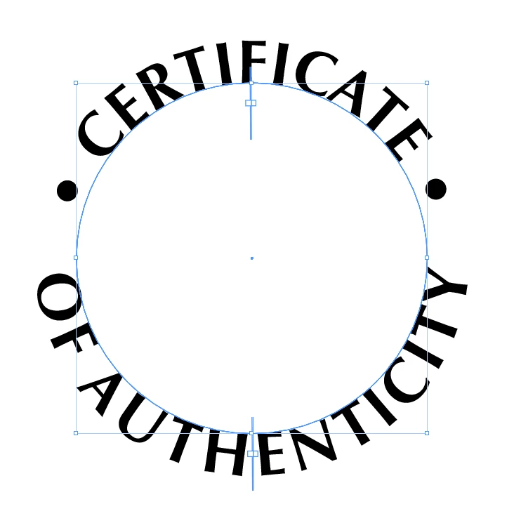

    There are pretty fast ways to create one line of type in a circle (see below) but you still need to center two circles for type on top and on bottom:
    https://indesignsecrets.com/center-text-on-top-of-a-circular-path-quickly.php
    One of the easiest ways to create two circles is to copy the first and paste in place for the second (after hiding the first). Edit the second, and then show both circles.

    I agree that Freehand made this very easy however it's really not that hard in Illustrator. Steve already outlined the general idea that you need two circles sitting on top of each other to achieve the effect which is easily done using the Align panel. That being said, I have a tip to make it easier to control where the type appears on each circle. Everyone's instinct is to click on the top of the circle with the Type on a Path tool which puts the text left aligned to that point. Not really helpful. My tip is to click on the bottom of the circle and type your text. Now change the text alignment to center and voila! the text is at the top! Make a copy of this circle using the Selection tool and right in the middle of the text will be a bar. Click on the bar and drag across the circle path and then spin it to the bottom. You'll then need to apply a baseline shift to the text on the second path to get it to align properly to the circle but that should give you what you want.

    I just type 2 paras in a text frame and create 2 circles! … After that, I select the 3 objets and just click!
