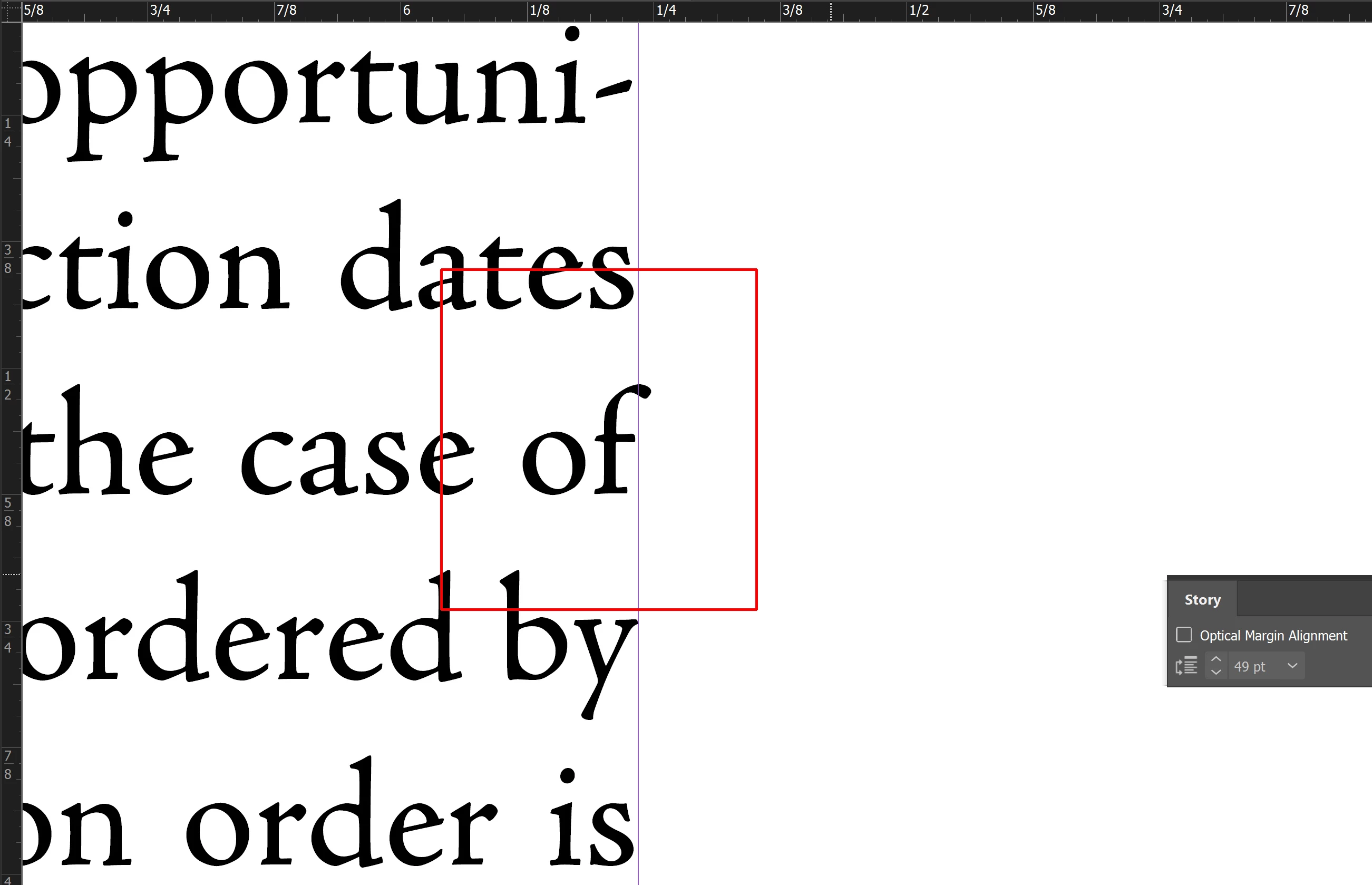

I can tell you that whether this is a bug or not, it's a MAJOR PAIN. Recently, Amazon KPD has apparently made their gutter restrictions more stringent, or updated their software to catch little things like this, and it has totally ruined my carefully planned layout. It's a 500+ page book with graphics and illustrations, very tedious with everything having a very specific place. And the font is serifed and some of the serifs go into the gutter no matter what I do, and KDP then flags it when I upload my manuscript.
I don't care if some people want it like this, there should be an option to absolutely make it NOT like this if other people want that. Just make an absolute option to keep all characters inside the margins no matter what.
  • Changing the Margins is not an option, because it throws my entire layout off, causing everything to jump down, creating more pages, which will essentially force me to redo the entire layout.
  • Changing fonts is not an option for the same reasons.
  • Changing the Optical is not an option, because it might fix the serifs, but it forces the quotes to dangle instead, and then there's no way to fix that.
This file was perfectly laid out using the requirements I was given, and it took a week to get it done. Now, I have to redo the whole thing because of one little software quirk. I don't know whether KDP is being too sensitive or not, but Adobe InDesign should definitely have a fix for this.

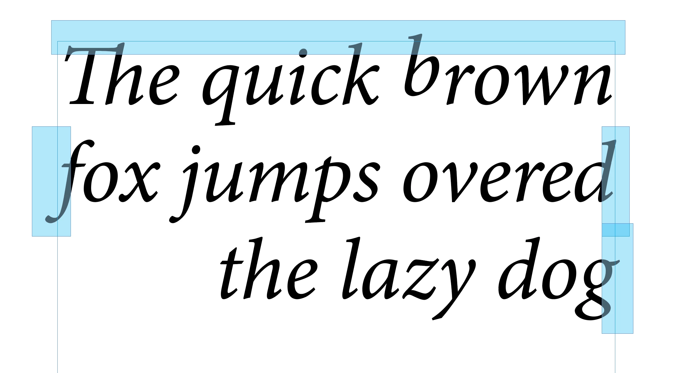

Hi @Pickory, I've put together a hacky script that shows (using blue rectangles) where each line of text protrudes from the selected text frame. I know this is probably not much use to you (because it doesn't fix anything), but because I've just written a very similar to a script I may as well share it. As I said, it's a quick hack—it literally duplicates the text frame and outlines it—so if you can use the SDK, then that would be much preferable.
- Mark

Edit 2023-04-11: now puts indicators on a new, non-printing layer, to keep them separate from artwork. @Eugene Tyson.

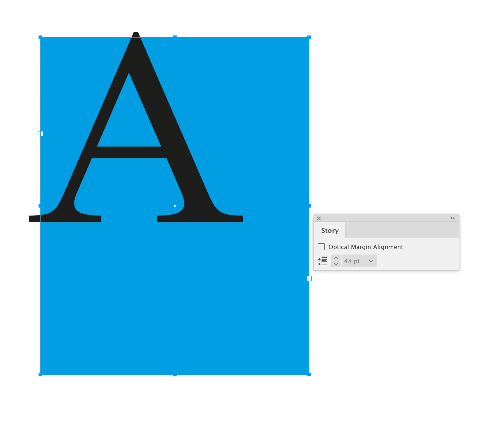

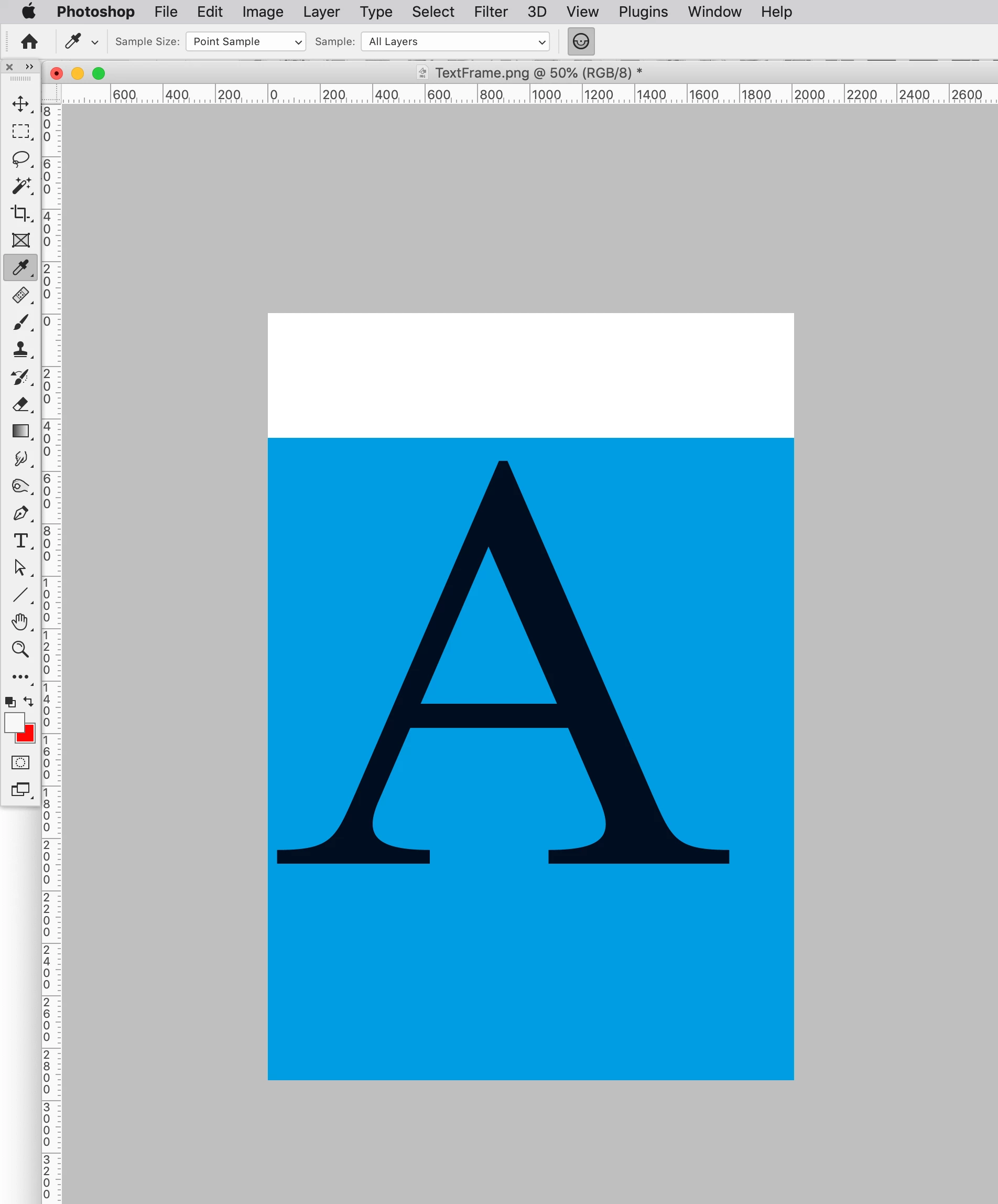

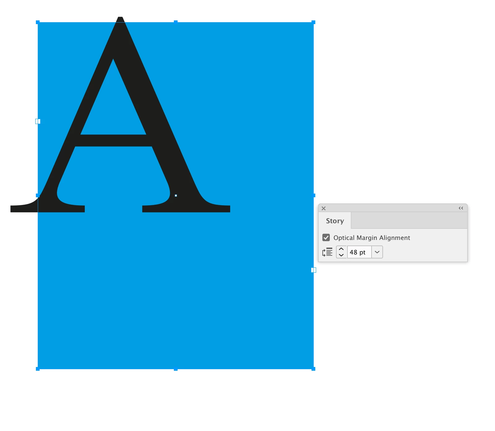

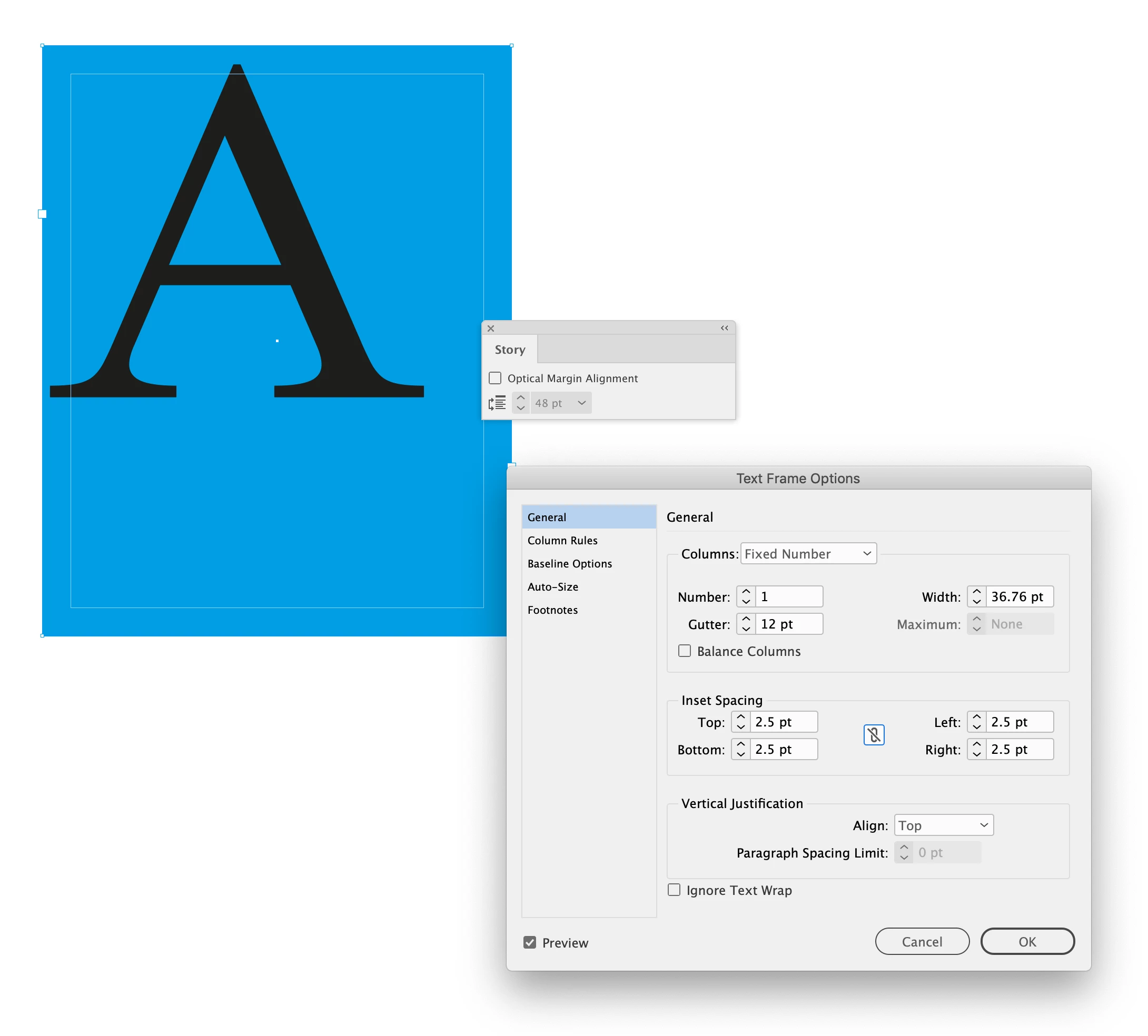

Apr 7, 2023 8:30 PM UTC
Hi @Pickory , The Story panel’s Optical Margin Alignment affects the amount of overhang, but even with it off there could be some:
The text fame can have an Inset Spacing of any amount set in textFramePreferences:
PNG Export:
