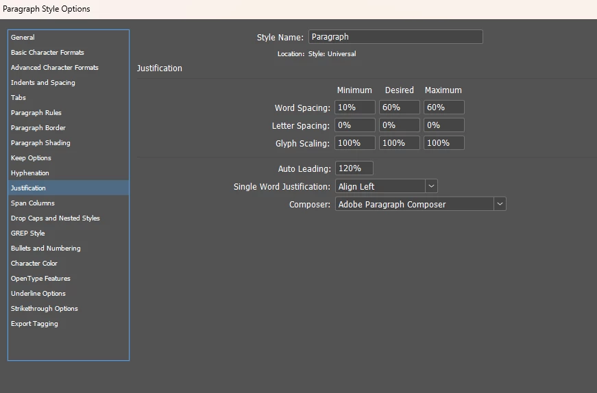

Aug 21, 2025 4:55 PM UTC
Not sure what a flush space is so I don't think I've used that. Here's the justification settings I have on that I found that someone else suggested on InDesign forum. It works for the spacing in between the words but still does a jump in the spacing.
