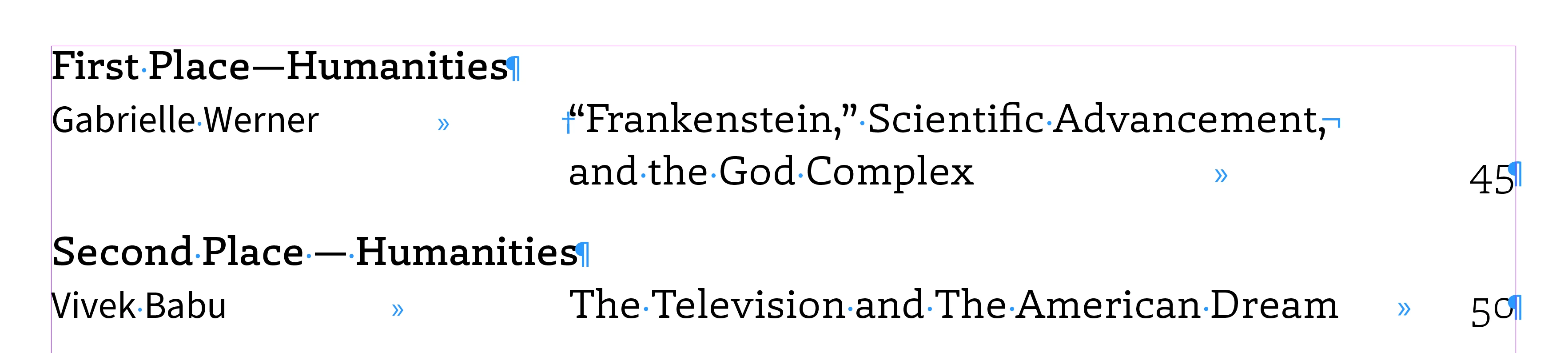

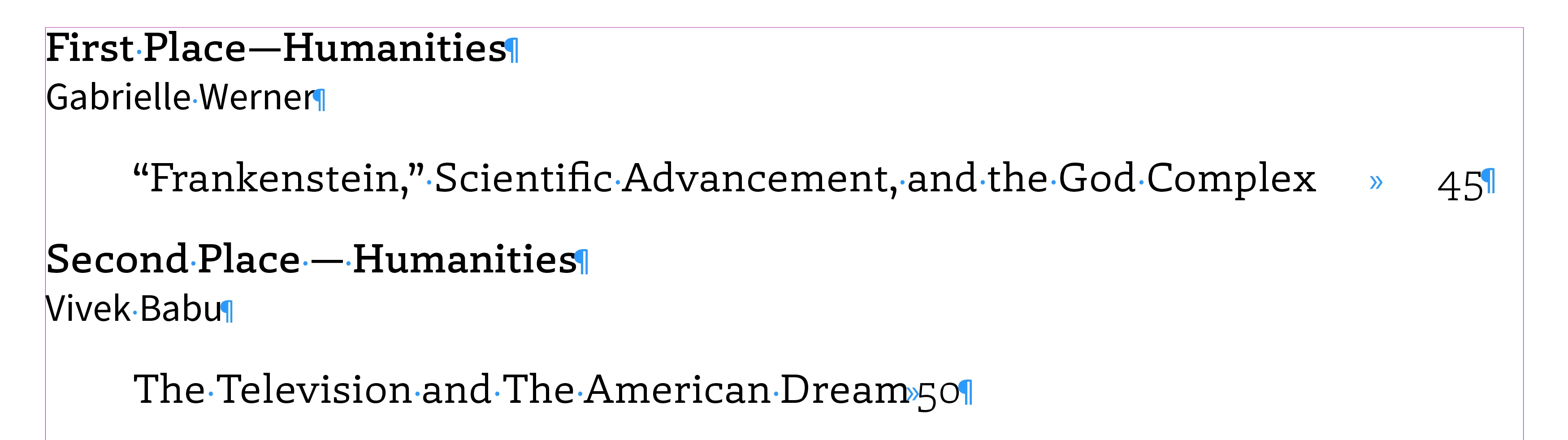

Here's how it looks, before & after. The ¶ after the Authors' names are replaced with the tab so that the titles align.
As noted, I have to then insert the Indent To Here where required.
 Before:
After:

I'm finding that with the current structure I have - which happens to look a LOT like the example posted by @Barb Binder, doing a simple find/replace works great.
Basically, I just did a find / replace on ¶ with "Author Name" style, and replaced it with >> (tab).
This then changed the "Article Title" style to "Author Name" style, brought it to the same line.
The TOC-generated tab and page # after the article title remained intact.
The only remaining editing, then, is to insert the Indent to Here symbol so that article titles too long for the current line align properly.
