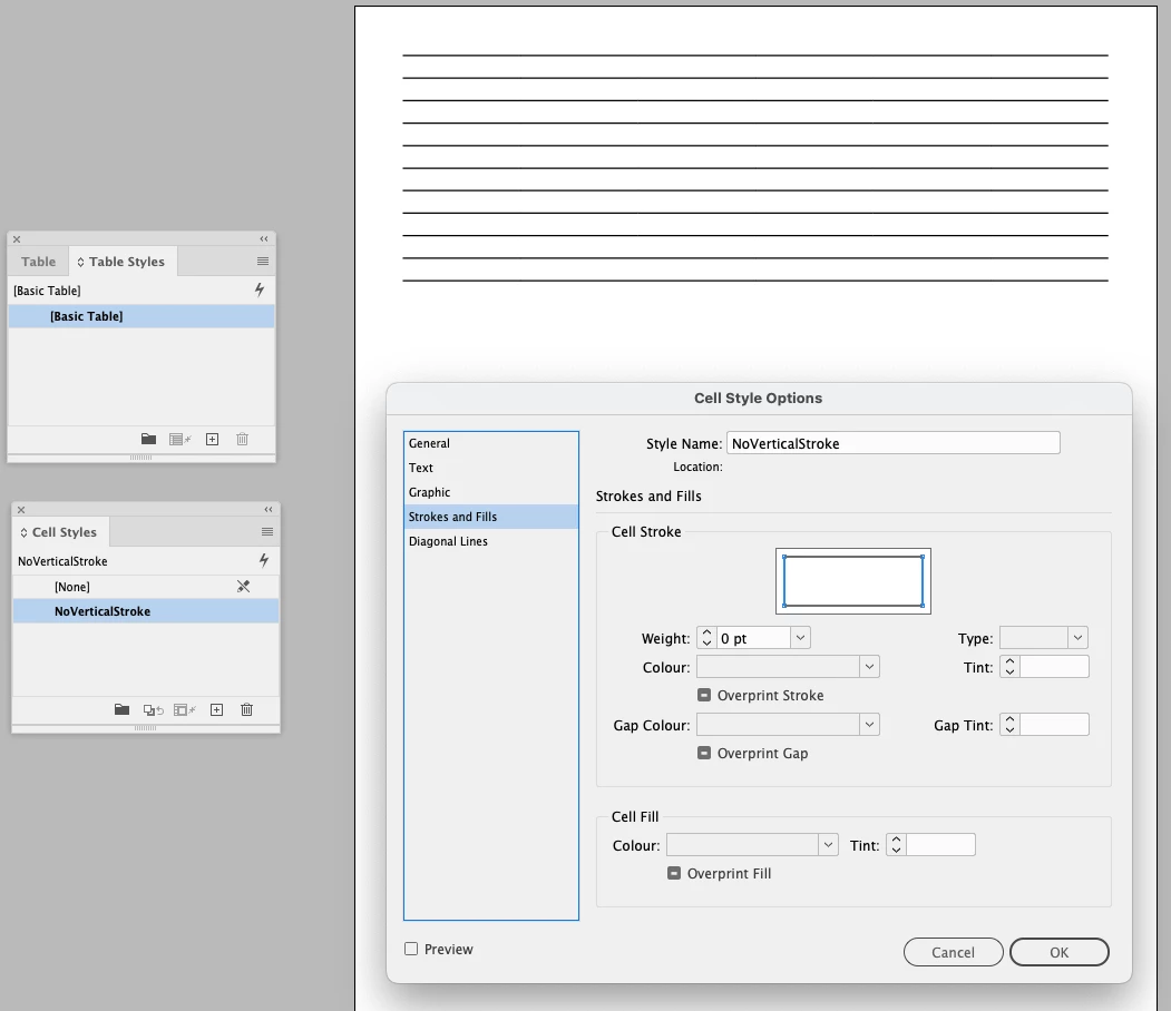

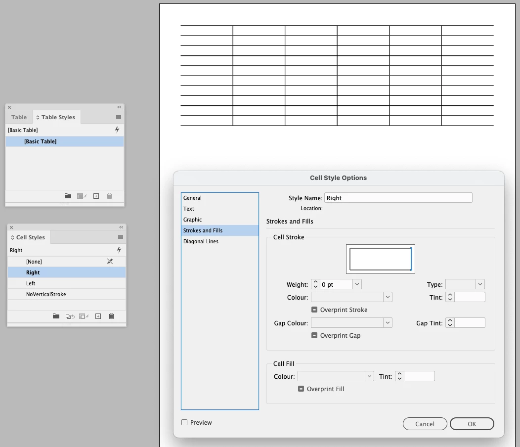

I am struggling to set up my table and cell styles.
I am trying to remove the vertical borders and preserve the top and bottom borders. I have tried every combination of cell styles, table styles, and table border setup imaginable and I can’t get the right result. I would appreciate any help.
Thanks

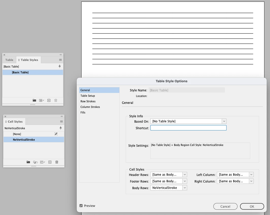

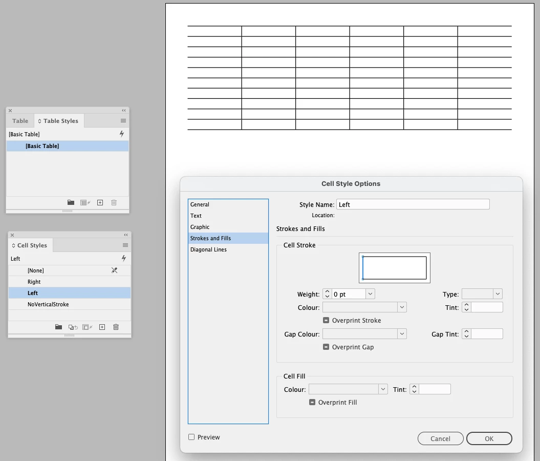

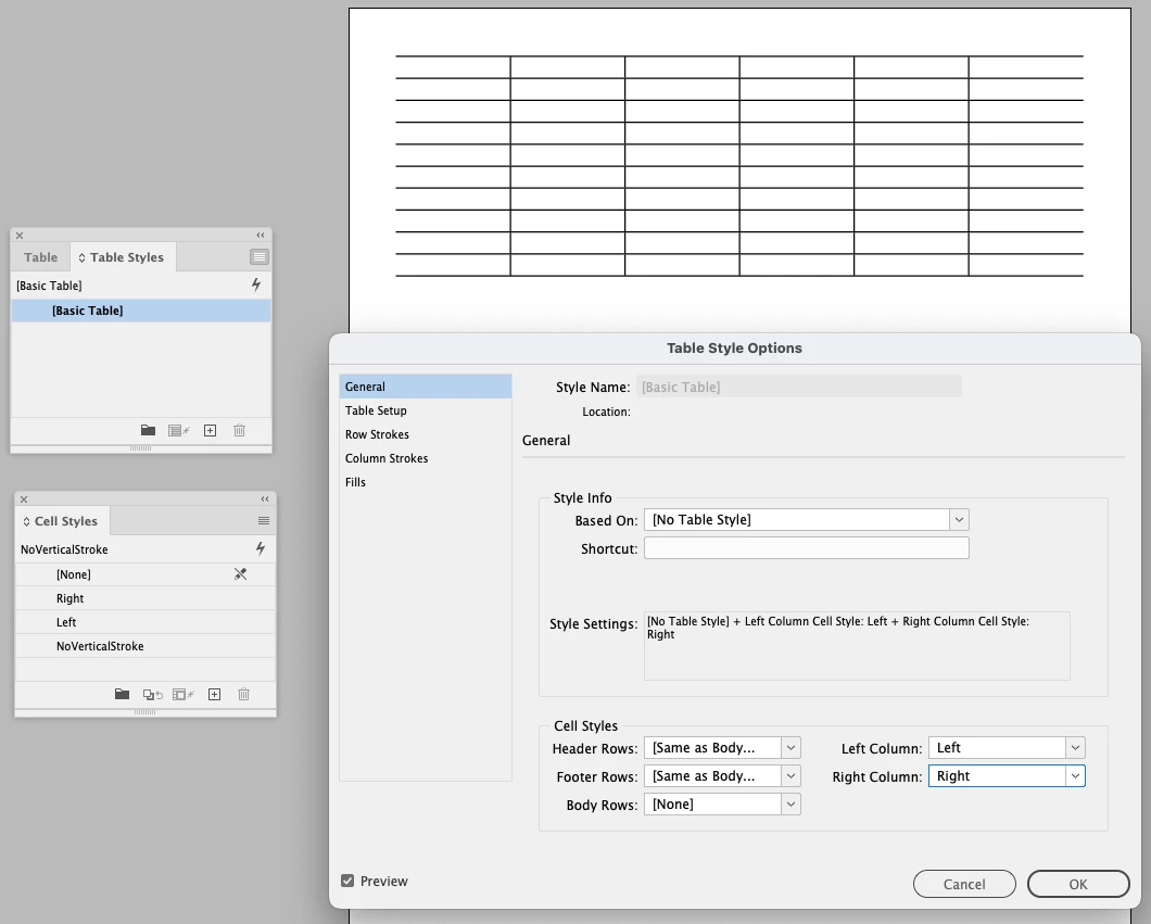

    Apr 14, 2026 9:31 PM UTC
    3rd and last try to post my test-doc!

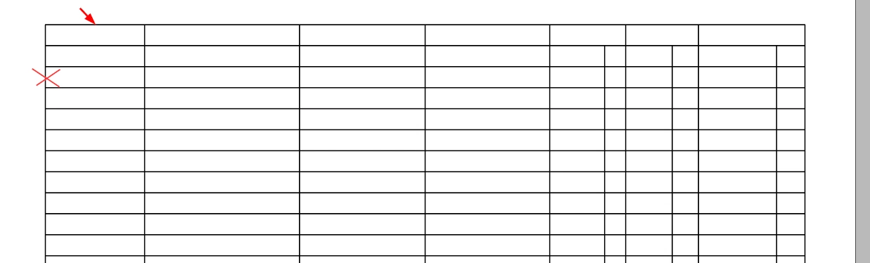

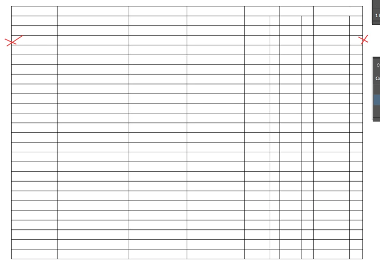

    Thanks for the suggestion. I should have given the full scope of the request - I am trying to create the below table with edge vertical borders removed
    FRIdNGE
    Apr 14, 2026 2:27 PM UTC
    Like this ? …
