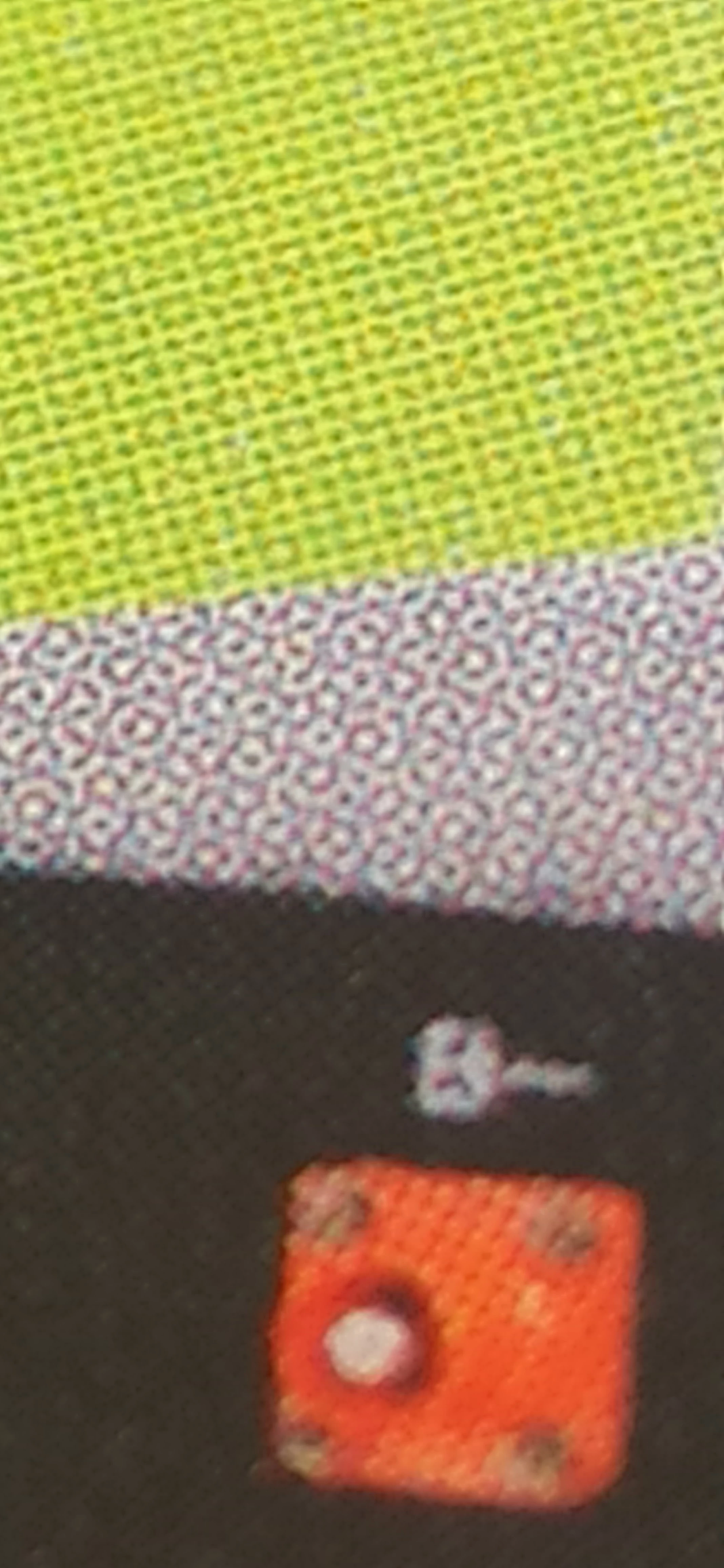

grazie Mike,
you are suggesting the same tests that I did too.
not having a magnifying glass here with me, I used the magnification of the cell phone camera. I did not notice any substantial differences...
I tried to smell but I come from a week of cold... not smelling the typical odor of offset printing I thought it was laser/inkjet...
