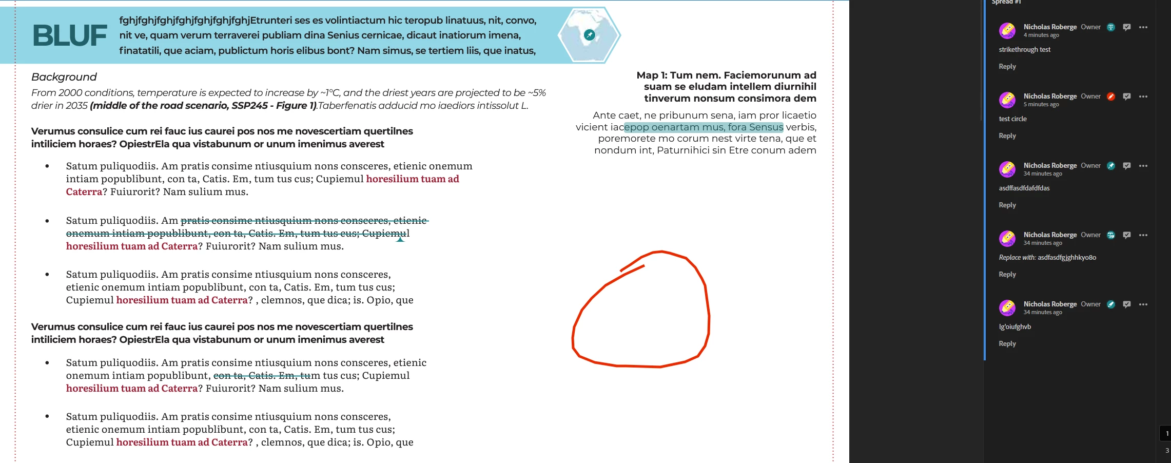

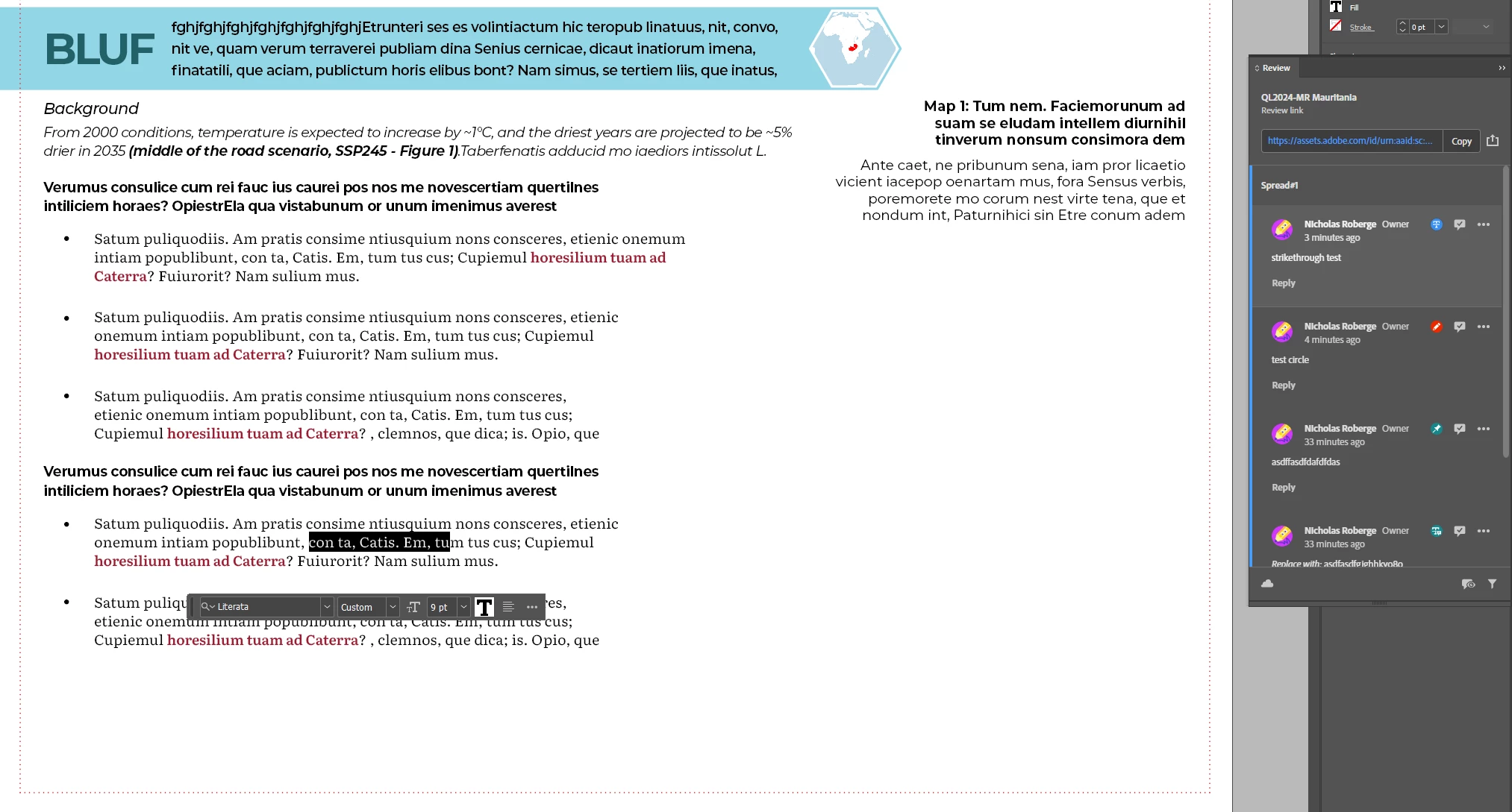

I am rather new to InDesign, but I have been trying to test out the share for review function and using comments in the asset that is shared on the web.
My test comments using any of the markers (pin, highlight, strikethrough, replace text, and draw) do not display the markers themselves in InDesign. When clicking on the comment in the Review window in InDesign, the text is sometimes highlighted, but gives no other visual indication as to what the comment is.
These comments sometimes show as "unmapped" also, but seem to vary for no particular reason. They're currently mapped to a spread now though.
Attached two screenshots of web view and InDesign view.
Thank you,
Nick

  1. 20.0.1
  2. Windows 11 Education 22H2
  3. Regular InDesign doc
  4. Additional
  • The unmapped comments were random. They are all mapped at the moment, but were not just earlier during testing.
  • I just created a blank document with some test text and the comment markers are showing there.
  • I have updated the content through share for review a few times.
I restarted my computer and the issues still persist with the original document.
