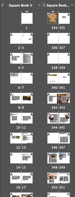

I have created a problem that I simply can't seem to resolve. The more I look at it, the less chance I seem to have of fixing it.
In brief, I am moving pages from two separate files into a new file. When I do so, the pages from one file are listed under a different layout to the pages from the other file. I don't want this. I'd like them just to be one continuous layout.
I can't see how to stop this happening nor can I see a way of combining them once they are in the new document. Can someone please put me out of misery?

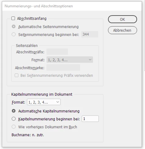

You said: "…nor can I see a way of combining them once they are in the new document".
At least that should be possible. You simply have to remove the section entry( not the alternate layout! ) on page 344 that I can see in your screenshot. To do that select page 344 and invoke Numbering & Section Options.
Uncheck checkbox
[ ] Start Section
From my German InDesign 2021:
Changed controls:
Note: If you try to remove the alternate layout all the pages of that alternate layout would be removed.
Not so if you remove the section entry.
Uwe Laubender
( ACP )

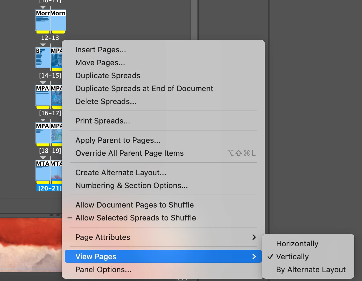

Feb 27, 2023 4:01 PM UTC
Hello! I found your submission because I, too, was having the same issue. I just happenstance found a solution for anyone with the same issue. If you highlight your pages on the alternate layout view, right click, scroll down to "view pages", you should find the alternate layout removed when selecting "vertical" or "horizontal".
Feb 28, 2023 6:48 AM UTC
Hi @minoo-liz ,
changing the view will not remove the alternate layout.
You still have some section starts like your screenshot is showing with page 12, 14, 16, 18 and 20.
Uwe Laubender

Dec 16, 2020 12:38 AM UTC
Uwe,
thanks so much. You are a genius!!! I hadn't even thought there might be a section insert there. I have made the change you suggested and it worked perfectly!
You are a gentleman. It's only thanks to experts like you who give up their time in these forums that people can get fixes to our problems and learn more and more tricks. We are so lucky to have you!
