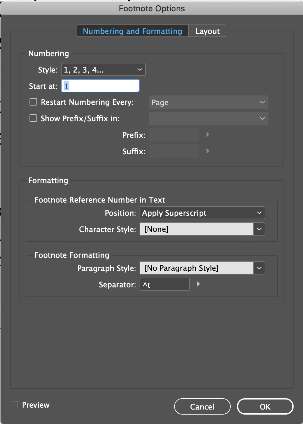

Thank you for sharing the Footnote Options screen shots. Unfortunately, that dialog box only controls the rule above the notes, and not below.
So you aren't using a Paragraph style—and now I realize you mentioned that at the beginning. Adding one would be benefical, because you can control the formaatting of all the notes at one time, incuding disabling what I am guessing is a Ruling Line Below (or perhaps a Border below).

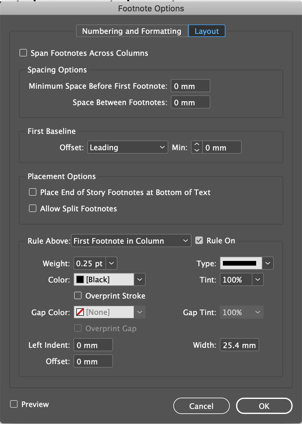

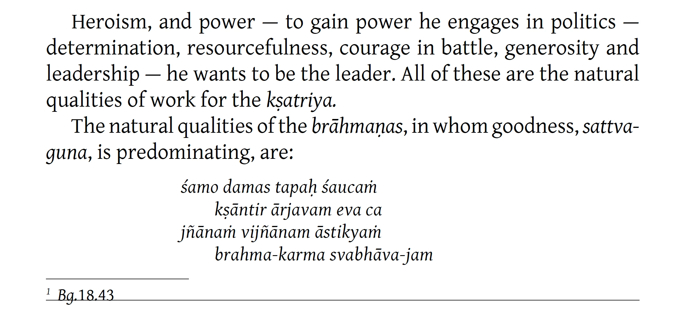

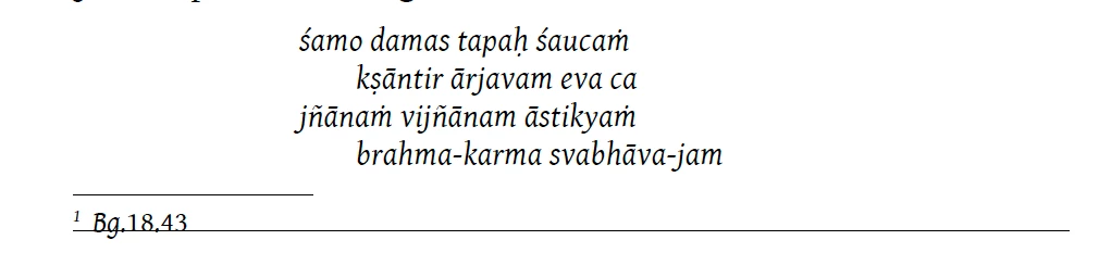

You say there is no paragraph rule (line), but in your screenshot the line is on the baseline so that hints that either rule above or line below is indeed turned on (for a single line 'sentense' both types of rule would be drawn on the baseline).

The "rule on" option is selected in Footnote options/Layout. I tried unselecting it. The result is that the top bar disappears, but the hairline below remains. It would be a lot of extra work, but I would be willing to manually insert lines above each footnote entry, if unticking the "rule on" box in footnote options/layout, would make both lines go away, but it doesn't. When I tick it off the bottom line remains.

Yes, I can see the line in your screen shot, but can't see why it is there. That is why I asked for a screen shot of your footnote style definition.

Thank you David. The "rule on" option is selected in Footnote options/Layout. I tried unselecting it. The result is that the top bar disappears, but the hairline below remains.

I'm inserting some screenshots of the page and also the options selected in "document footnote options".

You can see in the above screenshot. The top line is supposed to be there, but I can't figure out why the lower line is there. It's not there on all of the many footnotes in this book, but is there on perhaps 20 pages. I went to "Document Footnote Options", but I didn't seen anything that would cause this. In another discussion here someone else had the same problem which was solved by changing the paragraph style in the Document Footnote Options. I changed it to, "No paragraph style", and the line is still there.
