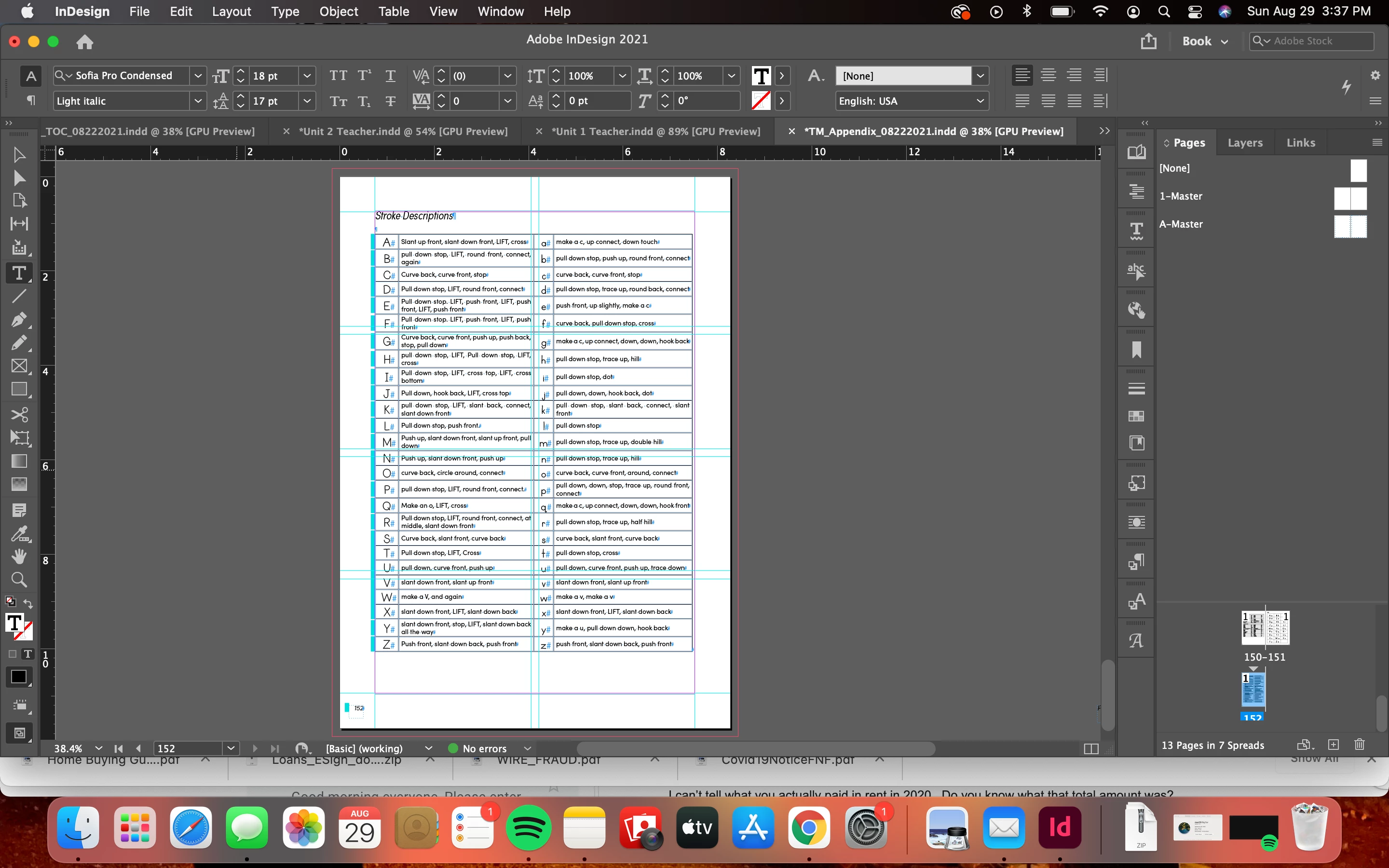

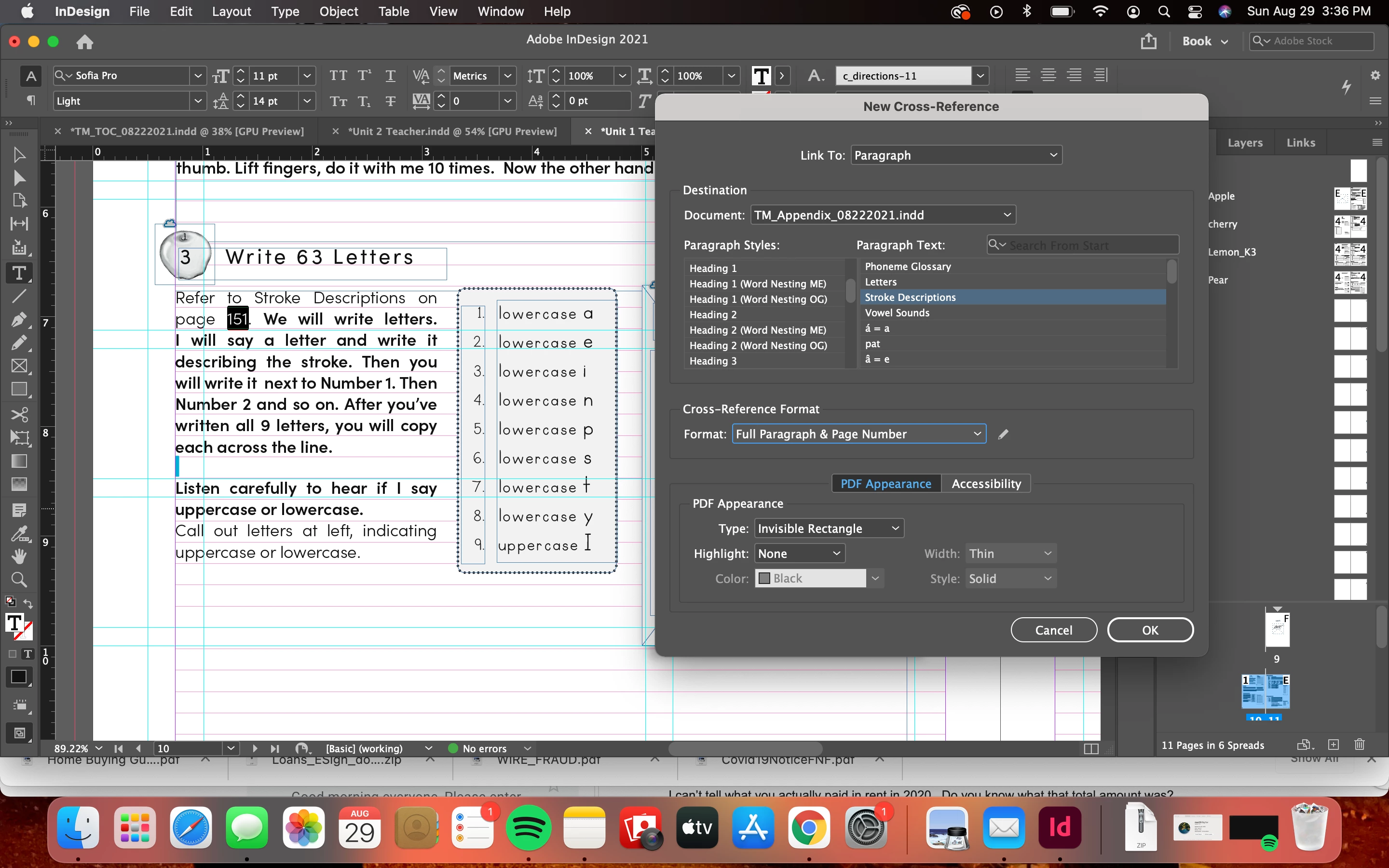

Hello, I'm having a similar issue. I do have an InDesign book with 17 docs. The cross-reference is pointing back to my appendix.indd where the page number is 152. However, my cross-reference still says 151. I've deleted the reference and tried to recreate it, and it is still saying 151. I've updated all numbers in the book, saved all docs and the book. Still, it says 151. Am I missing something? Any help is greatly appreciated.
Ms. Macfarlane
August 29, 2021
UPDATE: Wow! Ok, I discovered that the paragraph style was being applied to a Hard Return Space on the previous page. I inserted a frame break, and all is well again. I hope this hopes someone else in the future.
