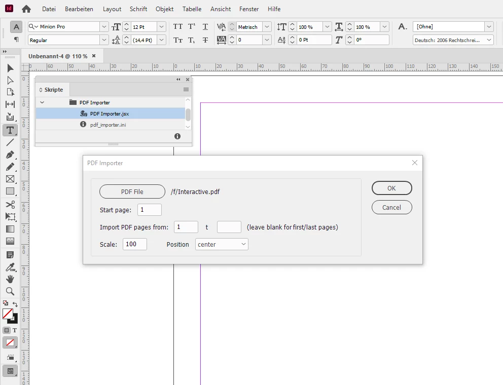

After Adobe's latest upgrade to InDesign installed, a script that we use to place & resize multi-page PDFs is no longer working in the Silicon version of InDesign.  There is no error gernerated and the dialog box never pops up.  If we manually run the Intel version of InDesign, the script works fine and it has worked on Silicon chips fine up until 16.3.2.
Any help is appreciated.  Attaching a .rtf of the script in question.

Hi defaultn2z0t92g6whx,
just tested the code with InDesign 16.3.0 on Windows 10.
It's working as far as I can see. Just launched the script's UI and placed a PDF.
The second launch of the script is showing the previously placed PDF, because the script writes this info to the pdf_importer.ini file:
Try the following:
Comment out the first line in the code like that or remove it:
// #target indesign
If this does not help do one additional thing.
Add this as the first line in the code:
alert( File($.fileName).exists );
If a script alert shows up with message false, we have a real problem.
If the message is true, we still do not have the culprit identified.
Important question:
Where is the script file installed?
Does the script show up in the User folder of your InDesign Scripts panel?
If not you should install it there.

LaubenderCommunity ExpertCorrect answer
July 26, 2021
Try the following:
// #target indesign
Important question:
Uwe Laubender
( ACP )
July 28, 2021
Thanks so much.  I had attempted a number of things, including editing versions based on other posts in the opening line:
#target indesign
None of those worked, but commenting out the line has fixed the issue, so:
// #target indesign
Just in case anyone searching for a script like this comes across this post, we hired a developer to build this script based on a previous script that was available in support communities that performed this same function after a previous Apple upgrade broke that script.  As neither the developer or us have claimed copyright protection on the script, you are welcome to use this script  as needed.
