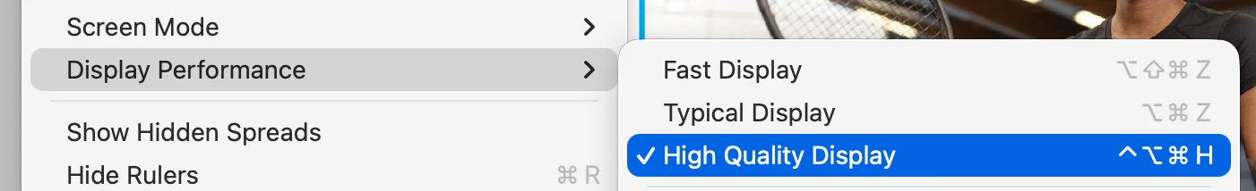

The images are very low rez but indicate that they are linked. The images are actually medium to hi rez
Is high quality display enabled?
Regardless, you may need to do quite a few manual adjustments after converting your .ai files; there’s no way to automatically recreate your Illustrator files in InDesign as is.
