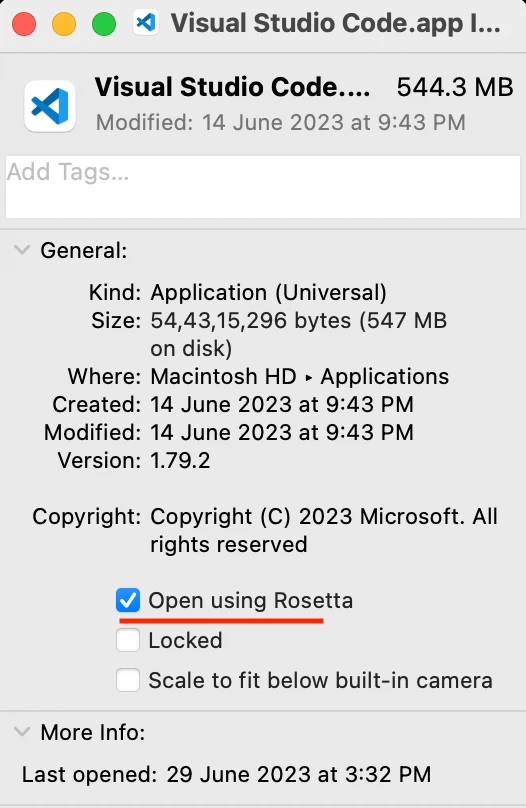

Found an advice elsewhere to install the intel version of Visual Studio instead which I did. I can now debug as I wanted. I can't do the quick right click>edit script from InDesign though since that won't open Visual Studio anymore. Not sure why but I'm not wasting time on it. I wanted the simplest solution to get to work so I'm content with this.

If you want VSCode to open when you select edit, you have to set the file extension's associated app:
In the Finder do Get Info on any .js or .jsx file and choose Open With, select VSCode and change for all (sorry I don't have my computer in front of me so my wording might be wrong but you will understand I think).
