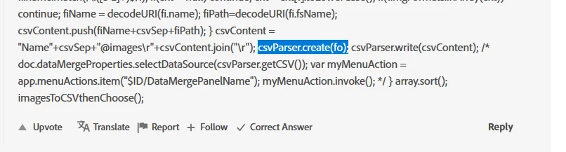

bellevue scott

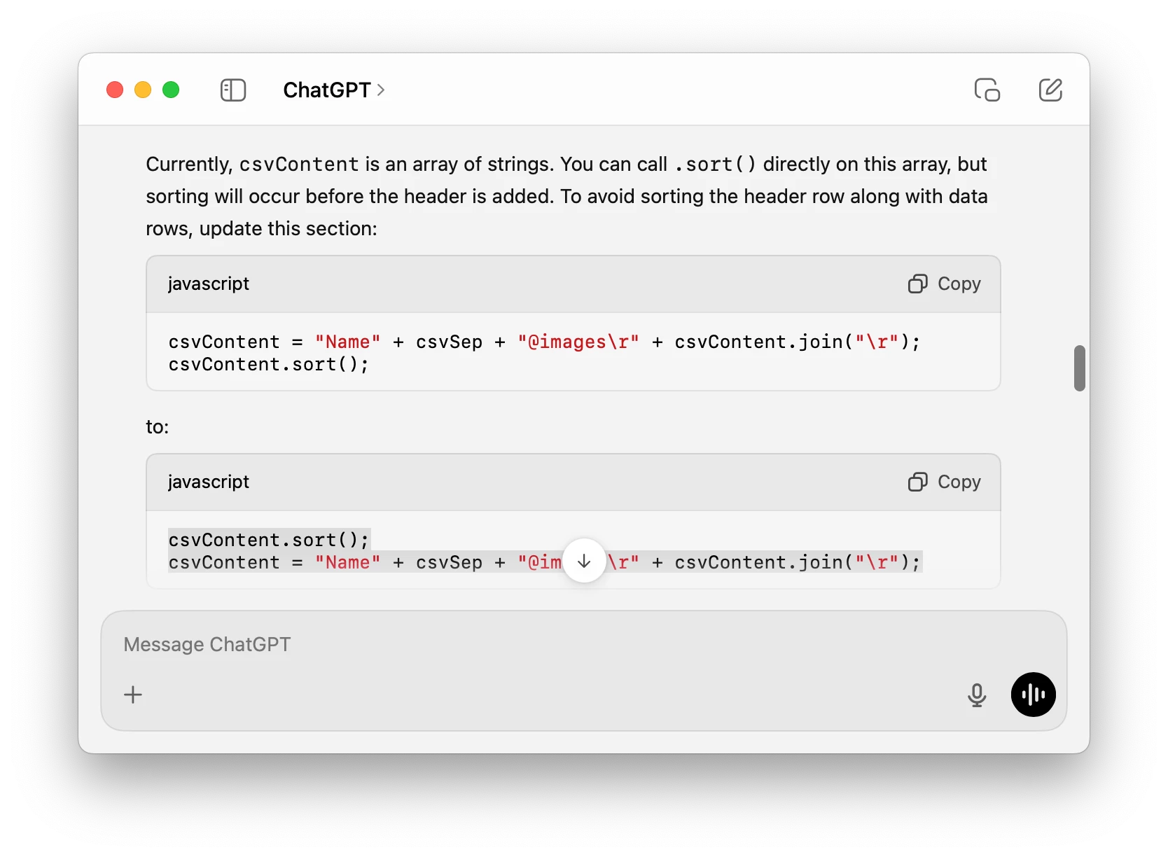

bellevue scottCorrect answer
Nov 5, 2024 11:20 PM UTC
Before marked part:
csvContent.sort();
So you should have something like this:
csvContent = "Name"+csvSep+"@images\r"+csvContent.join("\r"); csvContent.sort(); csvParser.create(fo);
Robert
thanks very much. You were close but I kept getting a javascript error. So I ran it through ChatGPT and it gave me the correct answer, and now I get a csv file that's already sorted.

Where might I put that array.sort(); ?
Array.prototype.inArray = function(obj){ var arrMax = this.length-1; for(var i=arrMax; i>=0; i--){ if(this[i]===obj){ return true; } } return false; } var csvParser = (function(){ var csvFile; return{ create:function(fo){ csvFile=File(fo+"/"+fo.name+".csv"); }, write:function(csvContent){ csvFile.open('w'); csvFile.encoding="UTF-8"; csvFile.write(csvContent); csvFile.close(); }, execute:function(){ csvFile.execute(); }, getCSV:function(){ return csvFile; } } })(); function imagesToCSVthenChoose(){ var doc, fo, fis, fiMax, fi, fiName, fiPath, imgFormats=["eps","jpg","tif","psd","pdf","png","ai","bmp","jpeg"], imgFormatMax = imgFormats.length-1, imgOk = [], csvContent = [], ext, csvLine=[], csvSep=","; if(app.documents.length==0){ alert("No documents open !"); return } doc=app.activeDocument; fo = Folder.selectDialog("Please choose a folder with images"); if(!fo) return fis = fo.getFiles(); fiMax=fis.length; for(var i=0; i<fiMax; i++){ fi=fis[i]; ext = fi.name.match(/\.([a-z]+)$/i); if(ext==null) continue; ext = ext[1].toLowerCase(); if(!imgFormats.inArray(ext)) continue; fiName = decodeURI(fi.name); fiPath=decodeURI(fi.fsName); csvContent.push(fiName+csvSep+fiPath); } csvContent = "Name"+csvSep+"@images\r"+csvContent.join("\r"); csvParser.create(fo); csvParser.write(csvContent); /* doc.dataMergeProperties.selectDataSource(csvParser.getCSV()); var myMenuAction = app.menuActions.item("$ID/DataMergePanelName"); myMenuAction.invoke(); */ } array.sort(); imagesToCSVthenChoose();
