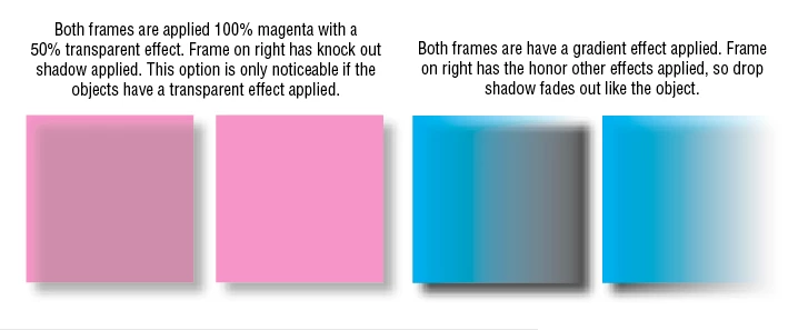

Here are the visual effects of these options, they only come into play if the object you are applying the drop shadow has another transparent effect applied.
