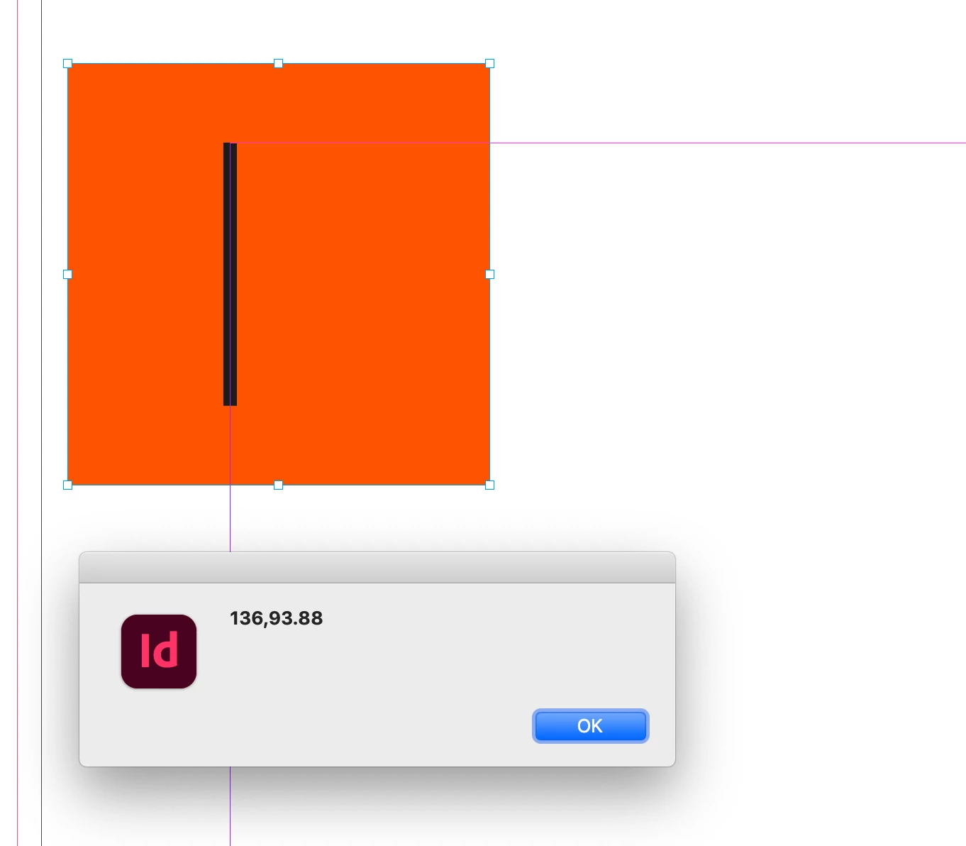

Or, if the line is pasted into a pageitem:
var gl = app.activeDocument.pageItems[0].graphicLines[0].geometricBounds
alert("X: " +gl[1]+ "  Y: " + gl[0])
To use resolve try this:
var a = gl.paths[0].pathPoints[0].anchor
//returns points
alert(gl.resolve(a,CoordinateSpaces.PARENT_COORDINATES))

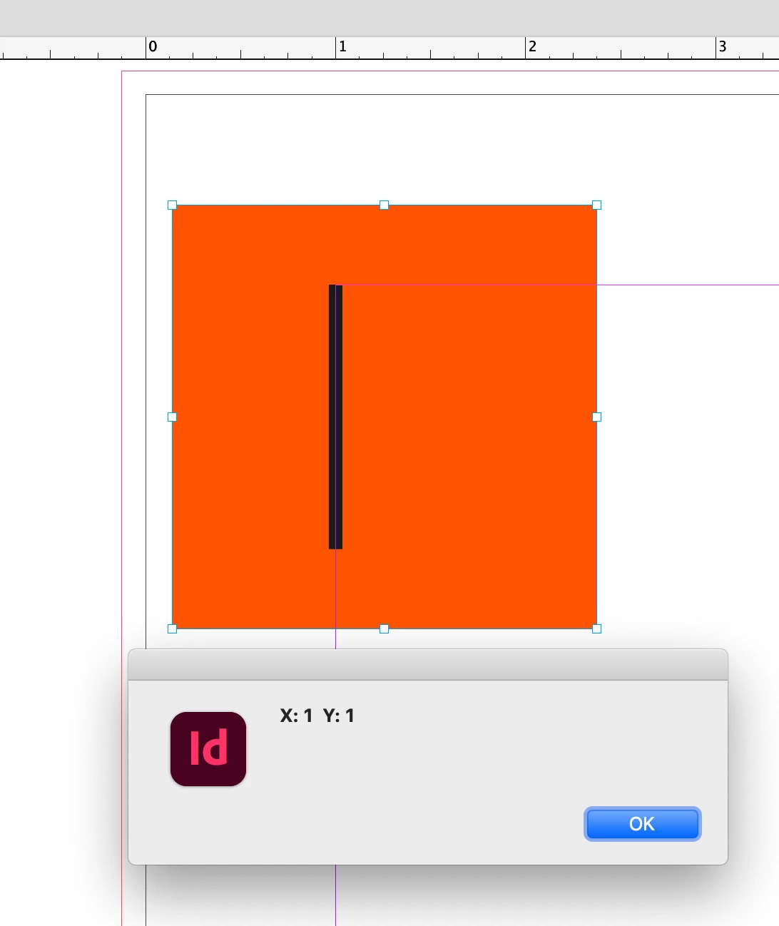

Hi @Øyvind235243823c6v , Try getting graphicLines:
var gl = app.activeDocument.graphicLines[0].geometricBounds

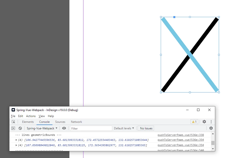

Yes, that gives me the frame position, but I need to get the position for the contents of the frame, i.e for each line start and end
E.g. these two lines will give me the same geometricBounds:
I need to find the find the x1,y1,x2,y2 point of each line. The x1,y1 of the blue line is not the x1,y1 of the black line
I was probably a bit unclear describing my problem 🙂
I've looked through all attributes and cannot find any reference, so I thought I needed to use a function like resolve()
