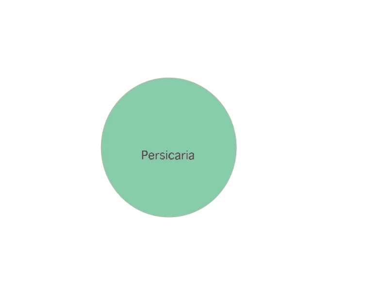

I'm trying to create circles and rectangles (and free form shapes) with centrally aligned text labels in the middle of them, is there a way I can vertically align the text?
I've found the Text Frame options, but the vertical alignment on this isn't quite centred, it's a bit too far down. Example attached.

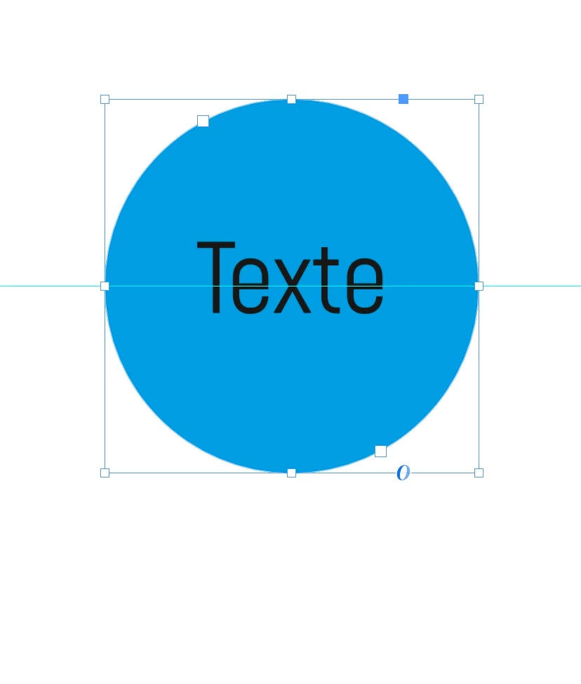

jmlevy

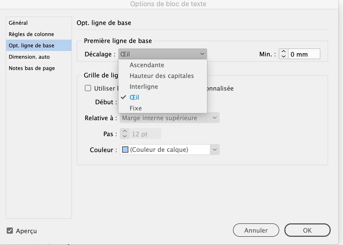

June 15, 2021
Adjust the baseline grid options in the text frame options
