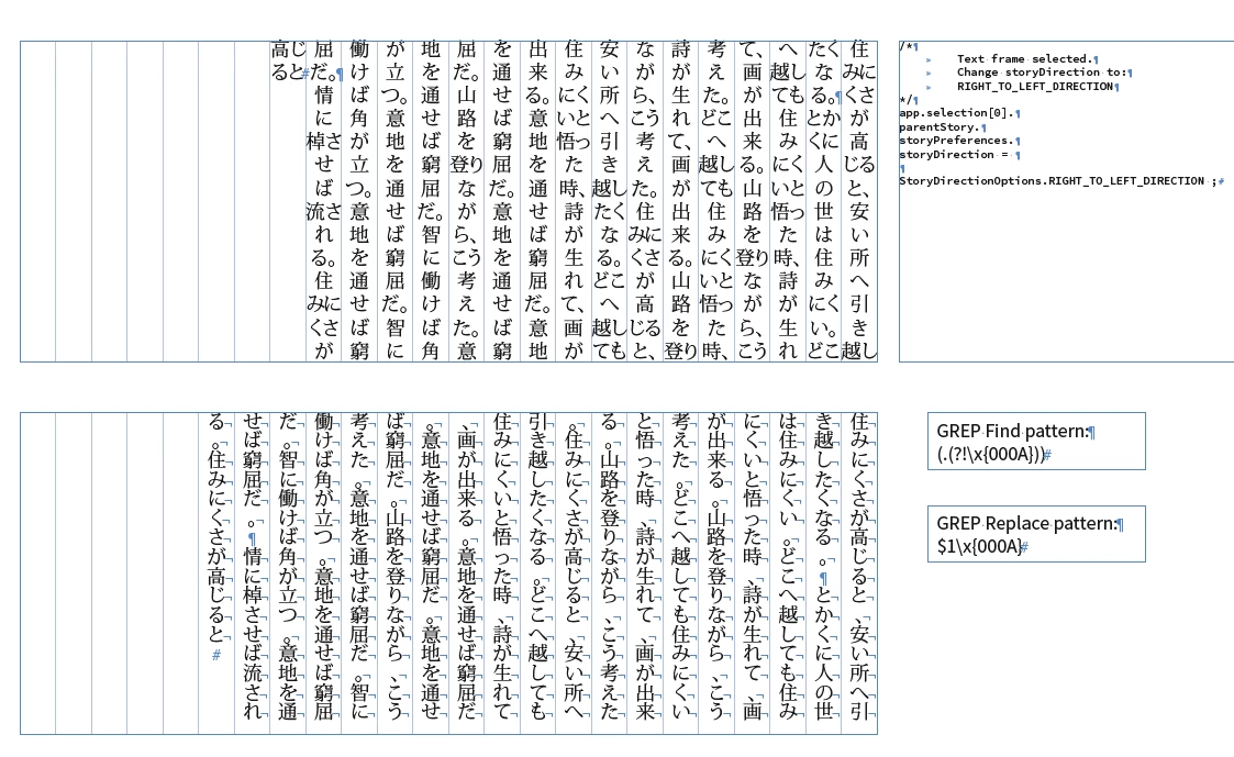

    Rafael5C40
    March 25, 2021
    I should have looked it up before. With vertical Japanese text reading direction is from top to down, from right to left.
    Ok. We can change that with the columns of a text frame as well. With a non-MENA version of InDesign like my German one, this requires a little script to get a result like this:
    Script code:
        First select a text frame, then run this code to
        change storyDirection to:
        RIGHT_TO_LEFT_DIRECTION
    app.selection[0].
    parentStory.
    storyPreferences.
    storyDirection =
    StoryDirectionOptions.RIGHT_TO_LEFT_DIRECTION ;
