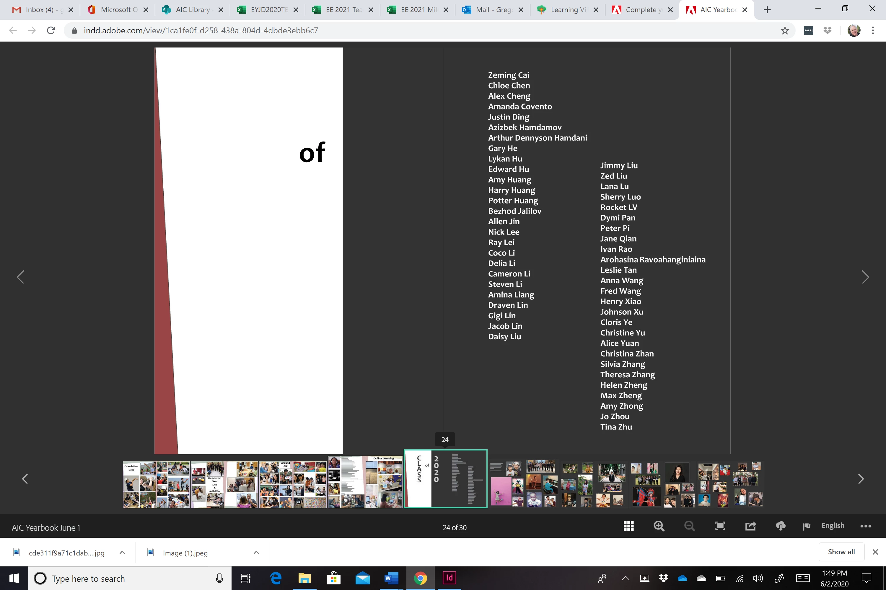

I recently published using Publish Online. The one page with vertical text does not show the vertical text in the full view, but does show it in the thumbnails (see attached screenshot). I tried a couple times to Publish Online in pdf format, then tried png. Same problems both times. If I export the document to a pdf, it works fine and the vertical text appears correctly. Any ideas? Thanks in advance.

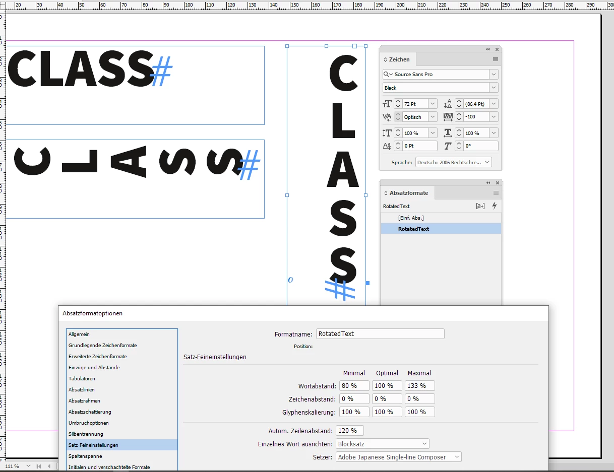

so because text on a path is not working, you have two options:
[1] Do every character in its own frame.
[ 2.1 ] Do rotated text by using the Japanese paragraph composer.
[ 2.2 ] Then rotate the text frame.
I assume that you are not using the Japanese version of InDesign so the Japanese paragraph composer is not directly available through the GUI. But you can apply it to selected text by scripting.
Just did it here to the special character auto page number:
https://community.adobe.com/t5/indesign/make-page-numbers-appear-in-column/m-p/11168048#M188186
The code is below.
Just select all the text you want to rotate by 90° and run the following ExtendScript code on your selection:
// Text selected.
app.selection[0].properties =
	characterRotation : 90 ,
	composer : "$ID/HL Single J"
After I selected all the text in the frame and running the script the result is this:
( Note: Also set tracking to value -100 )
The result can be published online without a flaw:
https://indd.adobe.com/view/c61fe0a3-5981-4ff8-911f-78ca7c4a4a42

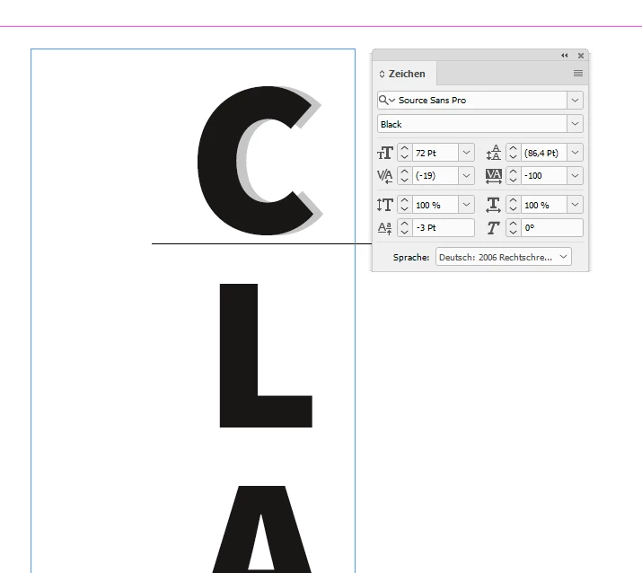

By applying baseline shift you could fine-tune the position of single characters like the starting "C" of "CLASS":
( Original position in gray. Did baseline shift with -3 Pt on the 72 Pt "C". )

Hi Greg,
The code is below.
// Text selected.

June 2, 2020
Hi Greg,
how exactly did you do the vertical text?
What's your exact version of InDesign?
Uwe Laubender
( ACP )
June 2, 2020
Thanks for asking.
I used the Type Along A Path tool.
I have version 15.0.3 x64
Greg
