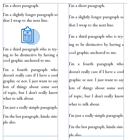

I have a multi-column flow of text with occasional headings. Each heading has a couple small icons anchored in a separate paragraph above the heading. I want to vertically justify all the columns, but it's not working. If there is no heading in a given column, in Text Frame Options I can set Vertical Justification alignment to "Justify" and it works fine. But if there is a heading (and therefore the icons, "Justify" acts just like "Top" - the bottom will not align.
After some searching on the web, I have discovered that it's the presence of any anchored object that causes the problem (see here on Reddit and here on CreativePro). Unfortunately those questions went unanswered, so I'll try asking myself. The attached image shows two columns - one with the anchored icons and one without. Both text frames are set to Justify, but as you can see, the one on the left is not doing that. I don't know if this is a bug or intentional behavior, but it seems weird to me.
Is there anything I can do about this, other than pulling my icons out of the text flow and manually placing them where they need to go (and then having to adjust their location every time some text is edited)?

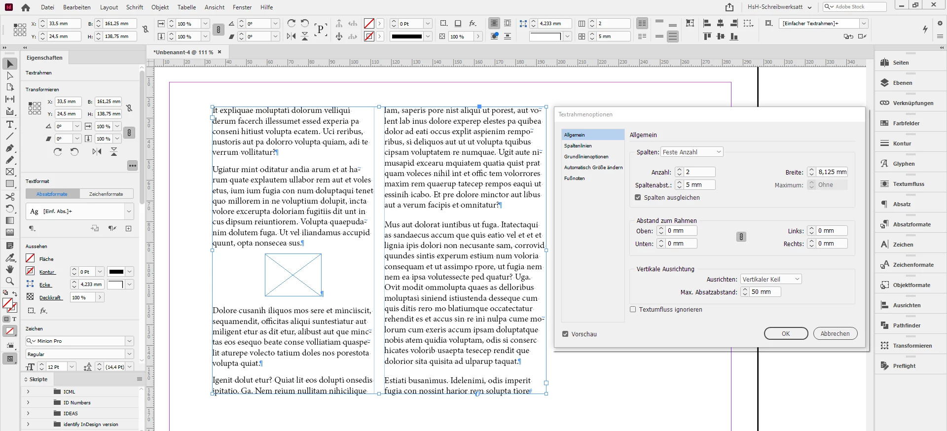

How is the vertical threshold defined? The Paragraph Spacing Limit for vertical justification. I set its value to 50 mm in my example.You may experiment with that.

Hi OsakaWebbie,
what's your version of InDesign?
Just tried something with my German InDesign 2021 on Windows 10 and cannot confirm the issue:
The rectangle is anchored to its own paragraph. The text frame has two columns. Maybe that's the difference here?
Your screenshot is indicating two text frames with one column each that are threaded together. Or could be the used paragraph composer the issue? I used the Adobe Paragraph Composer.
Or do I miss something important?

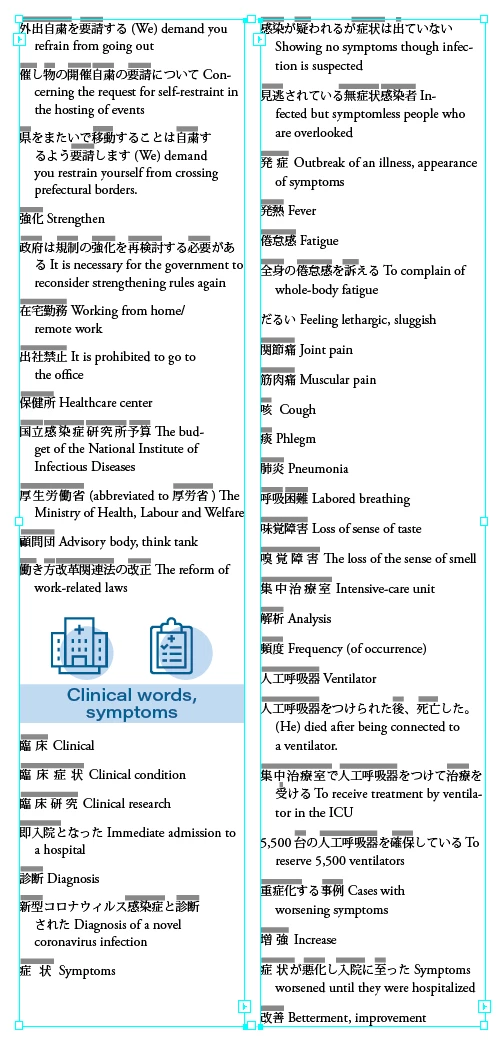

I have InDesign 16.0, English, on Windows 10. At the moment I have Asian features turned on temporarily (because I need "ruby" on this particular article), but others have compained of the same problem, so I doubt that's related. (And even if it is, I can't accomplish my goal without that, as the ruby is also the reason I'm making an exception for this article to not align it with the grid.)

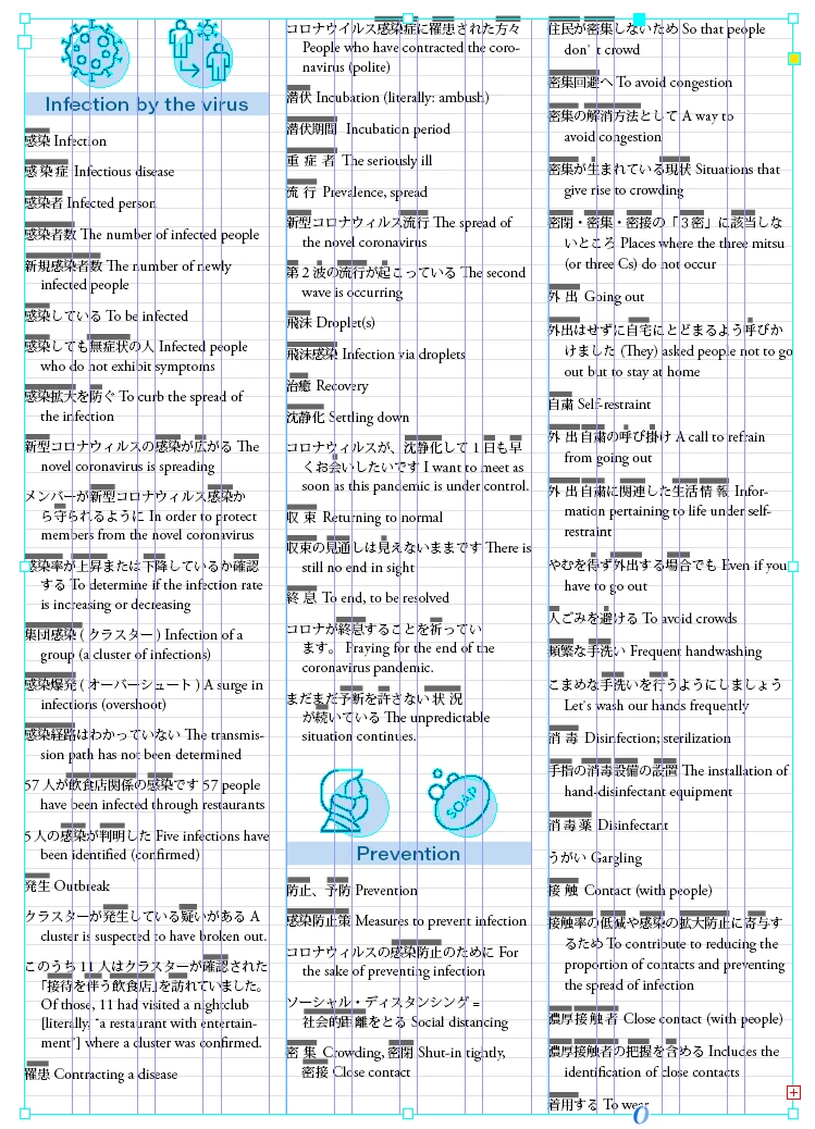

My case is a three-page article with eight threaded frames (three per page), five of which have anchored objects somewhere within their text. Your comment inspired me to try using a frame with three columns instead of three frames on a page, since the code for rendering those types of things could be different. But in my case it still fails - see attachment.
You also mentioned the paragraph composer - indeed, I have to use Adobe Japanese Paragraph Composer for this particular text so the ruby will display. But just for this test, I tried various others (Adobe Paragraph Composer, Adobe World-Ready Paragraph Composer, and the single-line versions of each), but although things shift around, the columns still don't align.
