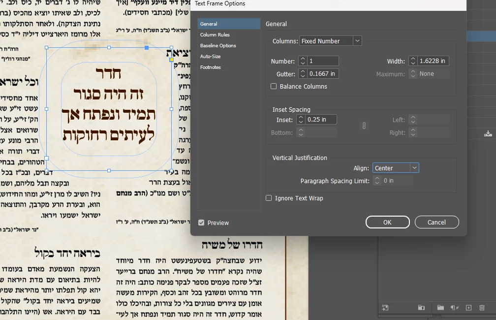

verticle alignment not seen!
why don't i see this verticalay aligned??

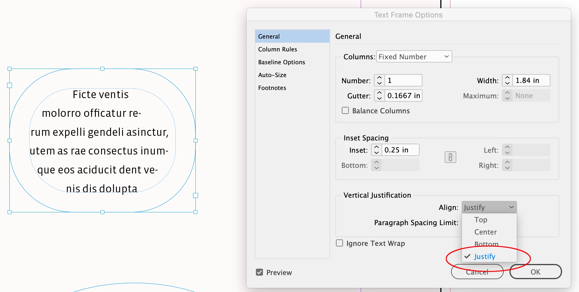

Hi @hendy_5450 , Can you show the Vertical Justification Align drop down list? Are you not seeing Justify as an option?

Nov 30, 2025 2:48 PM UTC
Try turning off rounded corners and it will begin to function again.
If you wish to have the rounded offset of textwrap, make that as a separate object to get back to your design which shows a rounded push-off of textwrap.

Dec 1, 2025 7:16 AM UTC
'make that as a separate object to get back to your design which shows a
rounded push-off of textwrap'
can you explain this clearly?
