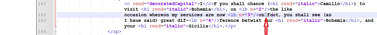

Well, the XML file says that it's in UTF-8 encoding, right? I have my install of Notepad++ set up to use a font that clearly doesn't support the non-breaking hyphen:
Support for the non-breaking hyphen is not really common. But after some further testing I'm finding that,  when I have Kis VF activated, this missing glyph isn't actually dropping. I believe that InDesign is substituting the normal hyphen-minus glyph and then treating it as if it has No Break applied.  So, a missing glyph is not likely as the cause for your hour-long wait.

1) The raw text in the XML makes extensive use of a properly encoded non-breaking hyphen. I don't have either of your fonts installed, so I replaced them with temporary placeholder fonts. If I choose a font that doesn't have a non-breaking hyphen, I get hundreds of "Missing Glyph Protection" warnings. If I
2) If I try to Map by Name, it locks up. I expect that this is because it has to try to map all of those hundreds of tags to style names that just aren't there.
