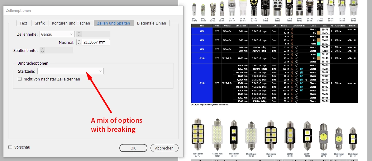

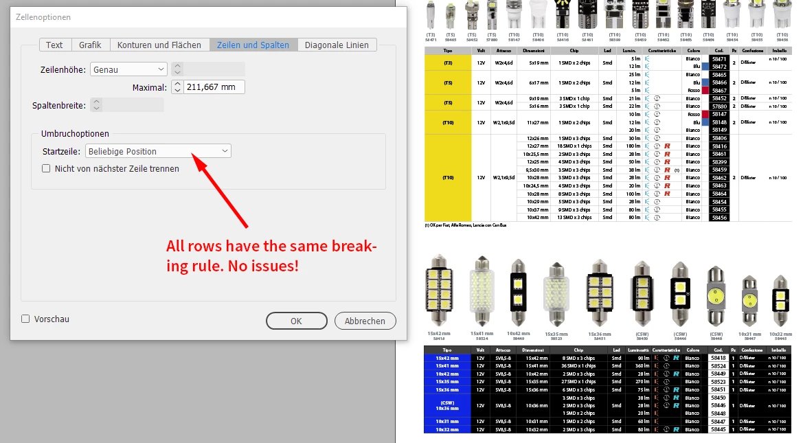

Correct answer Laubender
Hi Stefano,
looked into your InDesign 2020 document.
There are two tables on the page.
In the first table I can see the problem you describe.
In the second one at the bottom of the page I have no issues with editing the text in the table.
What's the difference?
You'll find a hint in the Cell Options dialog if you select the table:
Menu Table > Cell Options
Check the value for "Start Row". If it is a mix of values in the table you see a white drop down.
Default value is: "Anywhere".
From my German InDesign when the table is selected that is showing the issue:
The table at the bottom selected with no issues "Start Row" value is "Anywhere" for all rows in the table:
If I change the "Start Row" value to "Anywhere" in the upper table I have no issues with editing its contents.
That's the fix for your issue.

LaubenderCommunity ExpertCorrect answer
December 3, 2019
Hi Stefano,
If you want to do this for all tables in your document you could use a ExtendScript ( JavaScript ) script with the following code that is acting on the active document:
app.documents[0].stories.everyItem().tables.everyItem().rows.everyItem().startRow = StartParagraph.ANYWHERE ;
And yes, it's just one line of code.
How to work with ExtendScript code, save it to a script file, install and use the script file see:
http://www.indiscripts.com/pages/help#hd0sb2
Uwe Laubender
( ACP )
