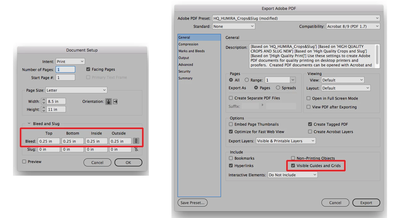

    Actually, Derek, I think that the printer may actually want the bleed lines (I've had this request). See screen shot:
    Make sure that the Document Bleed has been set in the Document Setup dialog window (first picture) and "Use Document Bleed Settings" is checked in the Marks and Bleeds section of the Export Adobe PDF window (not shown here) and that "Visible Guides and Grids is checked in the General section of the Export Adobe PDF window (second picture).
