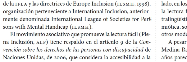

See that S at the end of the third line? It happens sometimes on hyphenated words when converting certain documents to PDF. Let’s say that it happens two or three tiemes in every hundred pages or so. I first saw this problema some three years ago. Does anybody know what is happening here?

Quite strange. it isn't happening with all htyphens, or even all cases of hyphens occurring at r-s breaks.
I tried export to .idml to see if that makes a differnce, but with missing fonts the type re-flowed and that break disappeared so no joy.
I did look for more info on the Minion 3 font in use, and it seems to be an OpenType conversion from another format, which might be a factor, or might not. Also, the Basic Paragraph style has a 5 pt baseline shift built in for no reason I can see, but removing it also causes the text to re-wrap. Issuing a Recompose All Stories command similarly changes the line endings.
In the file history it seems to have started life in version 16 in February of 2022, and there was a crash and recovery early on which could have caused some corruption. Not a lot of recent changes to the content, apparently, apparently, but many re-paginations as other files in the Book were edited.
Do you see this same problem anywhere else? I copied that text from the PDF into NotePad and it sees it as PerS, not Per-
I'm thinking it might be a good idea to go ahead and run this through .idml as recomposing the stories doesn't seem to affect the overall length of the document (no overset text or blank page) and see if you conmtinue to have issues with strage hyphenation if there is no good reason not to recompose (any edits you make after opeing in a new version will recompose the story anyway, so it's not like this may not happen during the course of work anyway).

Yes, it’s strange. It occurred only one time in the 96 pages of the last edition (before unselecting “Tagged PDF”). In other editions it has occurred roughly three or four times. Each issue of the magazine involves around a hundred pages.
The problem is that such an error force you to review line by line every time you export the document.

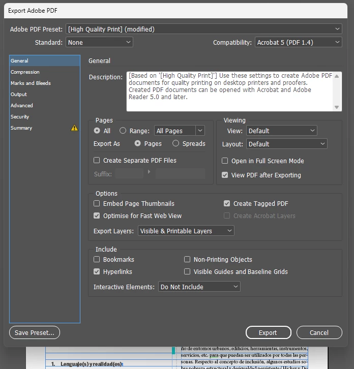

Can you share a sample document and your PDF settings?
I've never seen this - could be a language thing.
July 25, 2023
Sure. Thank you for your help.
See: PDF, page 49, first paragraph, second to last line.

July 25, 2023
I need to use the Adobe World-Ready paragraph composer. This is a magazine for translators specialized in medicine. Sometimes it mixes Arabic, Hebrew, and other RTL languages in the middle of Spanish, English, German, French, and many other LTR languages.
And... you are right! Turning off "tagged PDF" solves the problem. Nevertheless, this is a real bug.
Thank you very much.
