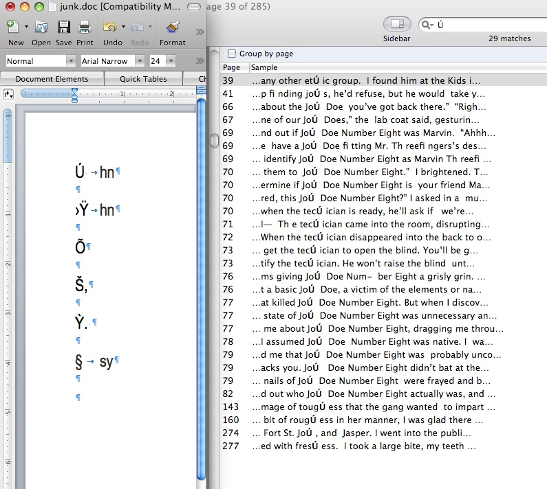

I work at a printing company and we do prepress on InDesign CS5 print jobs. We have ran into a type problem that we would like to know if others have had and if there is a preventative solution for. We've had two InDesign CS5 jobs develop this strange problem in the past month.
If automatic ligatures are turned on (and they are invariably), certain letter pairs will swap out with single glyphs as if they are ligatures despite the fact that they should not be ligatures. Once you turn automatic ligatures off, the pairs go back to the way they are supposed to be (but, all your good ligatures go away as well).
Here is an example:
In the document I have currently, the pairs ek and eh convert to the ligature glyph fi and the > symbol. Thus, if I type "seek behind", you would get "sefi b>ind". Turn off the automatic ligatures, and the problem goes away.
This problem is particularly insidious in that there is no warning for it. You load up the fonts, you open the InDesign file, and the pairs have changed themselves since the last time it was opened. If you aren't looking for it, you will not notice that it has changed.
Has anyone seen this problem or know what causes it? What preventative measures can be done to keep it from occurring other that manually turning off ligatures on all text in all InDesign jobs?

    I was able to get John as up as  JoÚ in the file all over the place.
    1. )    The JoÚ was being treated as an actual ligature, I could search for John and it would find the JoÚ.
    2. )    I turned ligatures off in the paragraph style and it reverted to John I then went and turned ligatures back on and it changed back to JoÚ

    I have been having an issue with Indesign and PDF files
    We are getting font character "Glyphs replacing other characters"
    Specs of the machines
    Mac OsX=10.5.8
    ID version=ID-CS5 ver 7.0.3
    Acrobat Distiller version = 8.0
    Fonts we have had this issue with
    Sabon LT Std.
    Garamond MT Regular
    Fairfield LT STD
    TimesLT Std
    Palatino LT Std
    Minion Pro Regular
    Verdana Italic
    Times New Roman PS
    Characters that have been causing the issues.
    io, il, hn, SY
    The characters they are replaced with.
    Ú Ÿ Õ Š §
    We run font cache cleaners such as Font Nuke, Font smasher and we even created our own from information found in other places where all the font cache's hide as well as suitcase's.
    We tend to catch this issue in out PDF files we are actually but it does show up in the Indesign file, but you can close indesign and then reopen it and the issue is gone.
    This lead us to believing it was a system font cache issue.
    We process many jobs on a given day via 3 different machines that are setup to create PDF files.
    We have a Process in place that before every job we clean the font cache and restart the machine.  Now I do not know if people are following this procedure all the time but we do have this issue appear like every 3 weeks when we get more work going thru the workflows.
    I am looking for other Solutions to what this could be, would upgrading to cs5.5 help solve this issue? Could it be Indesigns Preference file getting bashed as well?  How can I better search for these characters.
    We have been finding new characters it has replaced so its not always the same characters one time it was
    joŸ =john
    joÚ =john this was the latest.
    Thank you for any responses.

    This is similar to the issue we are having we get hn changing to Ú  or Ÿ
    Did upgrading to cs5.5 fix this issue or are you still having the problem?
    We also run cache cleaners before every job but this seems to pop up still.
